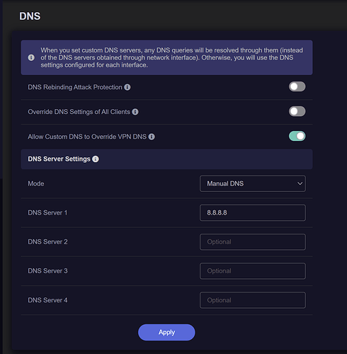

My goal is to use my wireguard tunnel (using pfSense wireguard server) as a DNS for the whole GLiNet router.

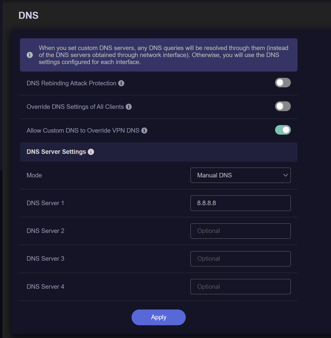

But for testing simplicity, I have added Google’ DNS in the custom DNS in Network → DNS, this setting has no effect. When I test the dnsleak, it shows the WAN’s ISP on dnsleak instead of showing Google’s name.

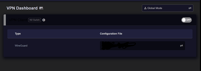

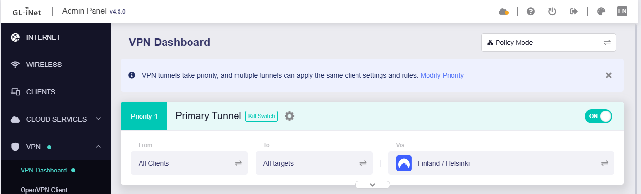

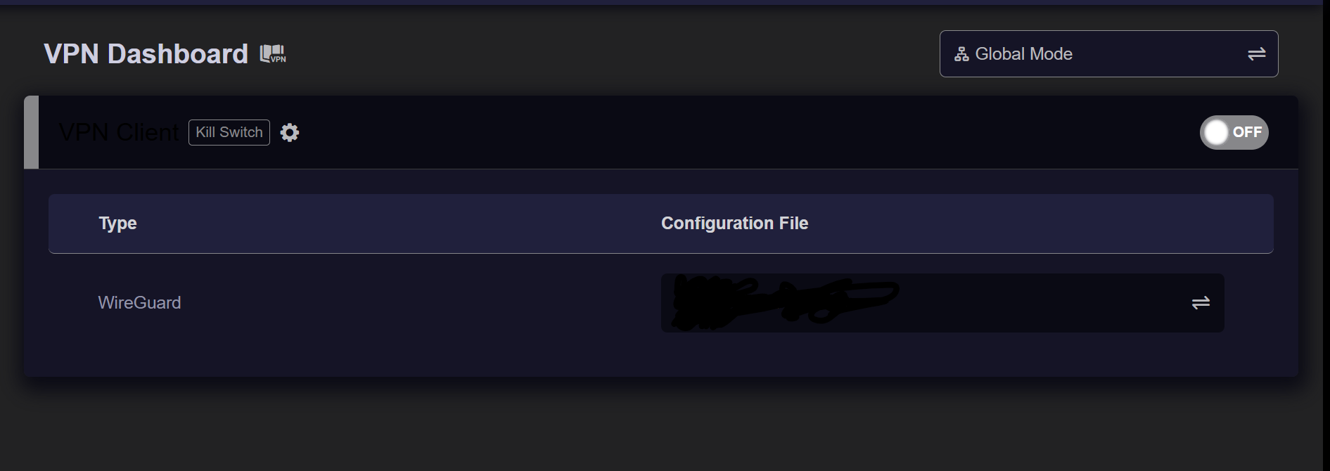

In the VPN Dashboard, the mode is “Global mode” and it is set to connect to the NordVPN. When the VPN is turned on, dnsleak shows NordVPN’s name and when the VPN is turned off the dnsleak shows the WAN’s ISP info. Instead of showing Google’s name.
I also tried with “Override DNS Settings of All Clients” turned on but it doesn’t have any effect either.

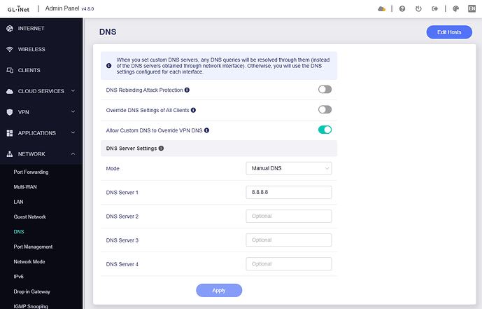

Here’s my setting:

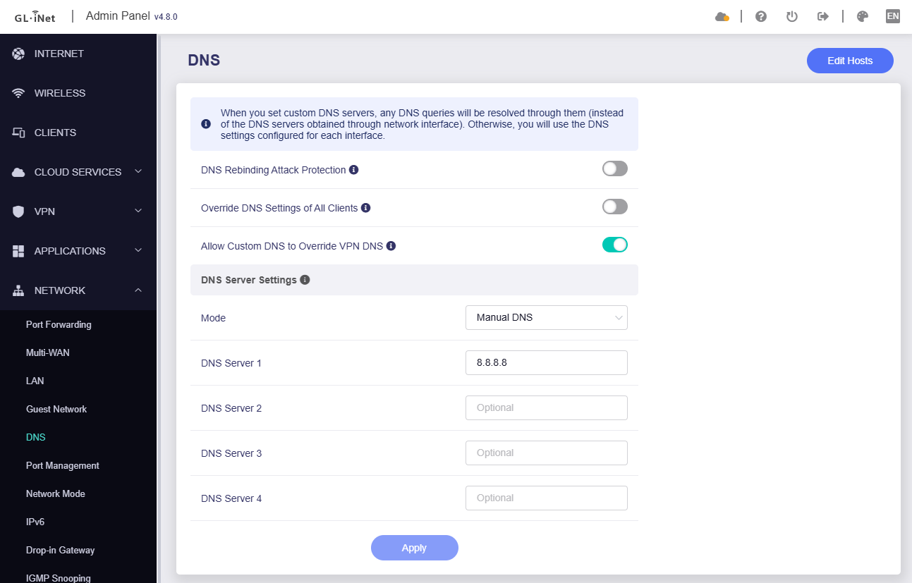

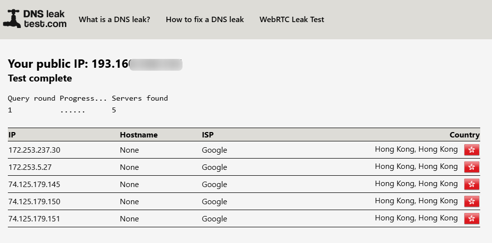

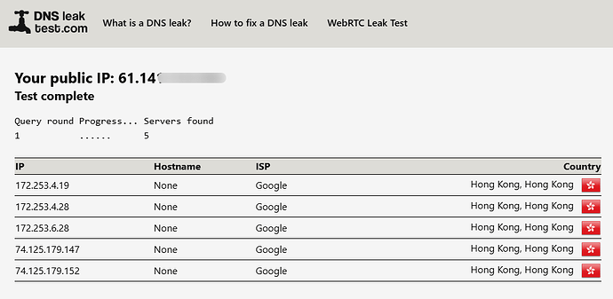

Just tested on my Flint3 with v4.8.1, this issue did not reproduce.
ISP WAN, Google DNS, Disable VPN:

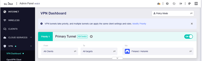

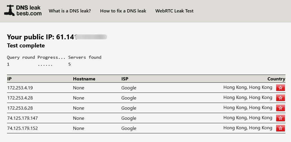

Same ISP WAN, Same Google DNS, Enable VPN client using NordVPN:

Question: Do you have any DNS set in the VPN profile. There’s an automatic default NordVPN’s DNS set in my VPN profile config. However, I think setting Manual DNS with “Allow Custom DNS to Override VPN DNS” turned on should override it, correct?

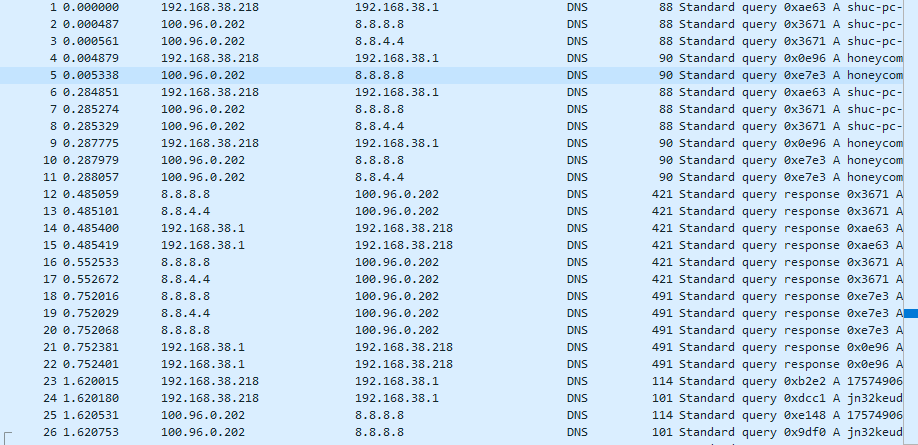

Sorry, I just tested this with NordVPN again and select Google DNS manually, it seems like 8.8.8.8 and 8.8.4.4 will be hijacked (not sure if it is really hijacked via VPN provider).
I captured the packet (port 53) on the router using tcpdump and saw that it was sent to 8.8.8.8 (dns.google), and the reply was also 8.8.8.8.
But in fact, the dnsleaktest.com test result is not Google, but NordVPN's DNS server.
Bit strange, only appear in manual 8.8.8.8 or 8.8.4.4 is selected, while manual 1.1.1.1 or 9.9.9.9, the results of dnsleaktest.com is CloudFlare or Woodynet Quad9, means only dns.google did not meet expectations. Let the R&D check.
Update:
Again checked this question by capturing the packet.
When DNS is manually set to 8.8.8.8, GL router does send the DNS request to 8.8.8.8, and the DNS resolution is also replying from 8.8.8.8, so there is no problem with GL firmware.
I think you can consult the VPN provider, why are there differences between 8.8.8.8 and 1.1.1.1/9.9.9.9.
