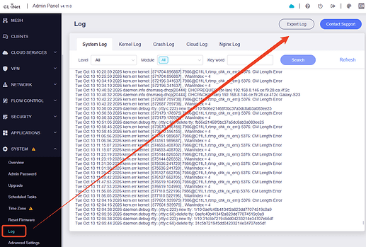

Regarding the IoT disconnection issue, please export the complete logs for all three routers in System < Log < Export Log.
