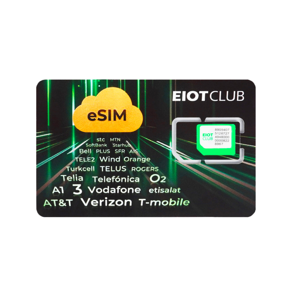

hey hi , goodmorning.
So you say or I understand I need to buy a Gli card, E Sim?
And its not possible to use e sims from other companies / providers?
I like to buy from Mobimatter a regional e simcard, I get the activation code (QR Scan?) with mail.
I think I understand it now.
You must buy such e sim first and then you can load / upload e sim profiles what you buy.
Is that right?
And if I like to buy a card in the Netherlands? Can I buy it there?
Of can I buy another Physical E sim what is doing the same like esim.me as example.
Then is my tip , change the product advertisement of the 750V2. that you need a physical E sim card first to activate E Sim
And I really hoped that you can upload E Sim profiles directly into the 750V2 without first using a physical E - Sim.
Hi Cdiepenheim,
For esim physical cards of other companies, we have not done sufficient verification, so we cannot guarantee that they will work.
You'd better buy GL.iNet esim physical cards.
