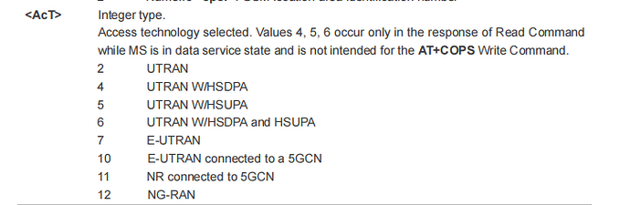

Hello, you can use this AT command.
The detailed introduction of AT commands is as follows:
Provide a use case:
root@GL-E750:~# gl_modem -B 1-1.2 AT AT+COPS=? #Search for surrounding network carrier
root@GL-E750:~# gl_modem -B 1-1.2 AT AT+COPS=2,2 #Deregister from network
root@GL-E750:~# gl_modem -B 1-1.2 AT AT+COPS=1,2,\"46001\",7 #Manual operator selection
root@GL-E750:~# gl_modem -B 1-1.2 AT AT+COPS? #Query the current carrier
