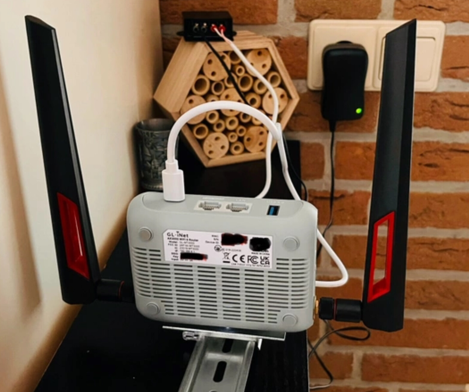

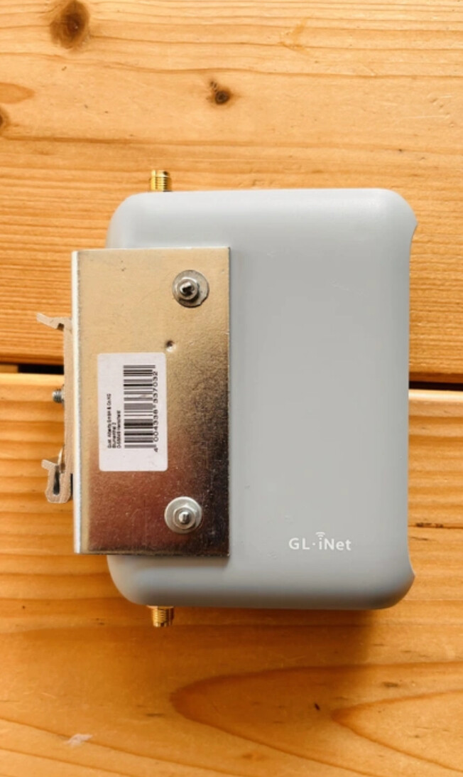

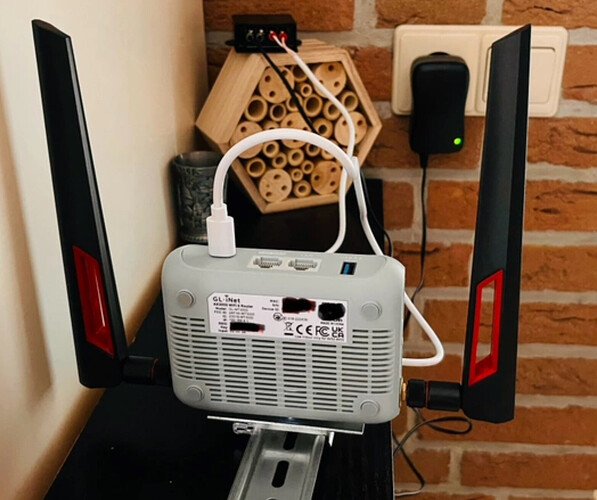

This is how I did it with my Beryl AX. I removed the original antenna’s and put a SMA connector in place so I can use external antenna’s on my boat to catch harbor wifi. On the photo’s The antenna’s are removable. I have added rail mount to as it Will be put inside a panel

This antennas in the first pic are not for LTE or 5G frequencies. I am talking about an external outdoor antenna.
