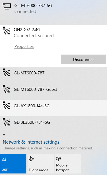

I tried reproducing this issue on my SFT1200 with v4.3.25, there seems to be work ok, both the PC and iPhone can search for SFT1200 which customize changed to OH2D02-2.4G SSID, and connect ok.
