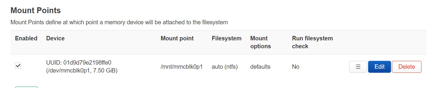

Why am I not seeing any of the Mount Point options on my new Beryl?
I have inserted a blank 8GB MicroSD and then powered on the device.
Under applications its only 12MB free.
What’s the best way to determine it’s seeing the new storage?
I’ve been going into Plugins and seeing the available space at the bottom. Currently not seeing the bigger storage there yet, unless I’m looking in the wrong place.
