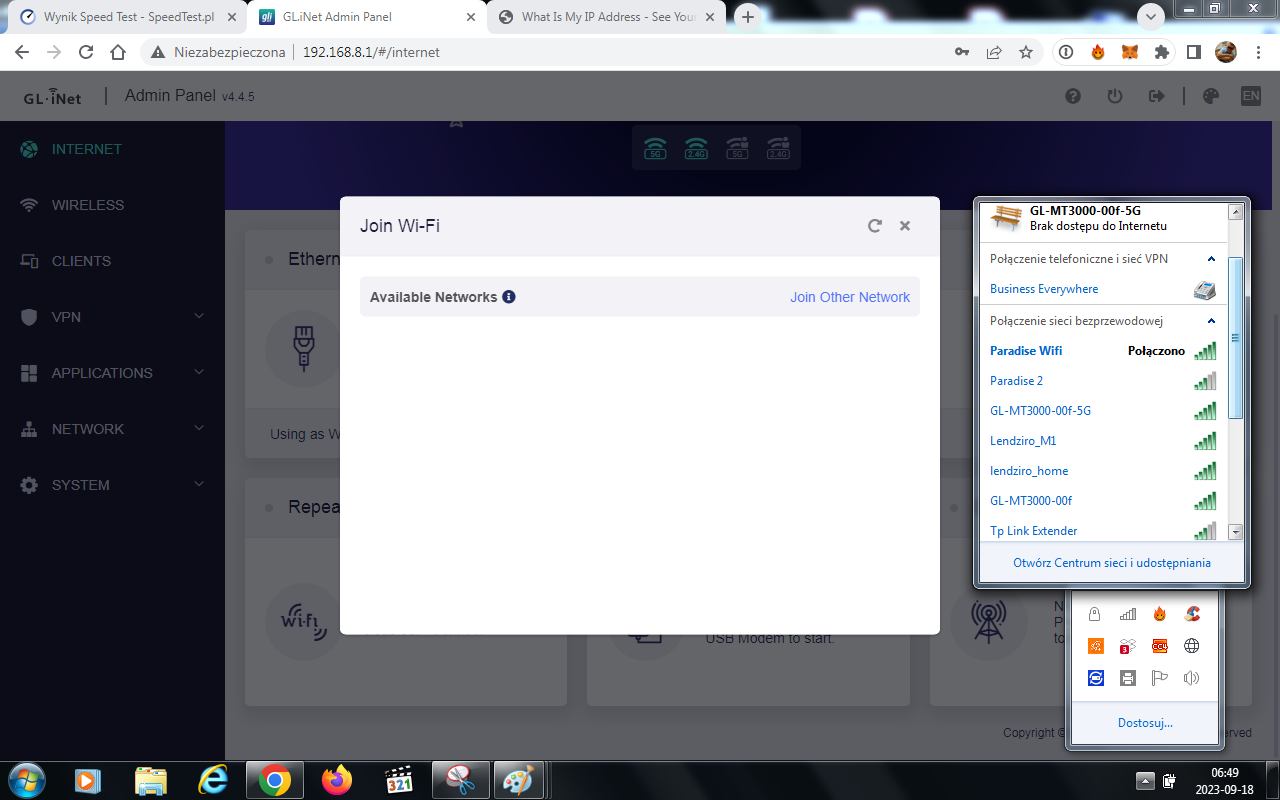

a few days ago everything was ok. Today I wanted to scan the list of available wifi networks and it doesn’t find any one. When adding a Wi-Fi network manually, I also cannot connect. I decided to restore the factory settings, after logging in again there was still no wifi available.
I have a Mudi 750 router turned on next to it, so I can see many networks available. On the mt3000, none of them.
What could be the reason?

I checked everything again today.
I have two rutets next to each other
MUDI 750 and the are a lot of available networks - everything is OK.
Below are screenshot from MT3000 (connected via LAN cable) with the current software version is 4.4.5 compile time 2023-08-11
Picture shows list of detected networks → none .On the same screen is a window from computer’s Wi-Fi card, you can see many available networks.
You can also see the available network of the MT3000 itself
also after entering the network manually, i cannot connect.
I can send the logs but I need to know which ones.
I also attached screen how looks like list of MUDI 750 in the same time

I did it. Reset the firmware . After that:
  1. I set admin password.
  2. check upgrades now have stil software version 4.4.5
  3. Search wifi and the result is still the same. No list with wifi
    have some informationa about EAP - dont know exacly whati is it.
    EAP
also have such defoult options
Any idea to help me? Or maybe it is a phisical problem so i can retutn this device and get another one?
