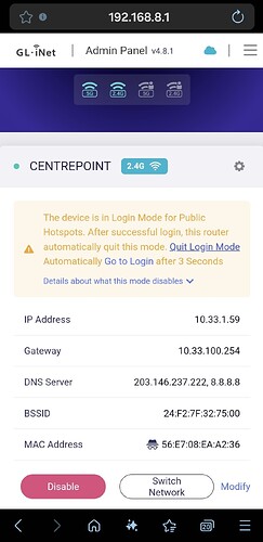

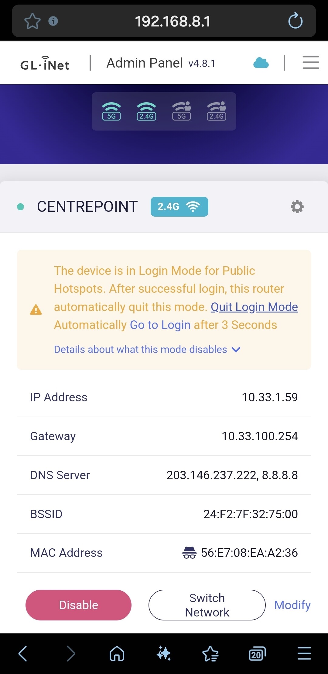

I'm currently using the MT3000 (Beryl AX) router while staying at a hotel that uses a captive portal system for internet access (Centre Point Hotel, SSID: CENTREPOINT). The router successfully connects to the hotel's Wi-Fi network in Repeater (WISP) mode, and it receives a valid IP address from the hotel’s DHCP server, but the captive portal login page never appears.
The router enters "Login Mode for Public Hotspots" as expected, and I’ve tried both clicking “Go to Login” in the admin panel and manually navigating to HTTP sites like http://neverssl.com, but still no portal is shown. Client devices connected to the router cannot access the internet.

Device Info:
  • Model: GL.iNet MT3000 (Beryl AX)
  • Firmware Version: 4.8.1
  • Hotel Wi-Fi SSID: CENTREPOINT
  • Issue: Captive portal login page not appearing, no internet access for clients

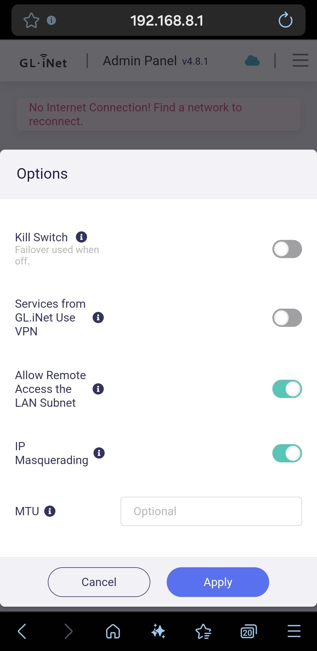

Hello VTURM,
maybe you can try to allow “All Other Traffic” in die VPN Dashboard.
Best regards,
Routinator
  1. as Routinator mentioned, please try to enable the All Other Traffic” in the VPN Dashboard first.

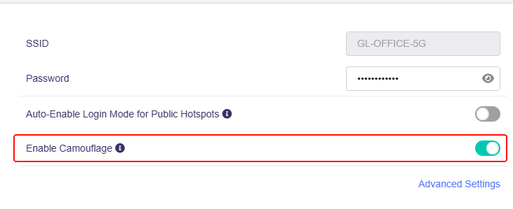

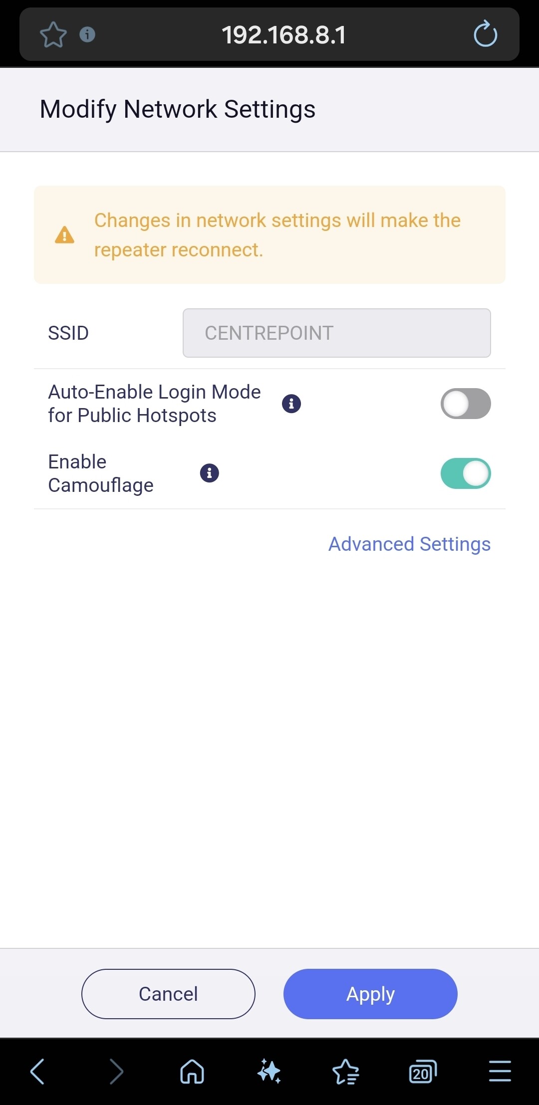

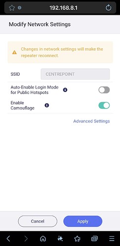

  2. please enable Camouflage option in repeater:

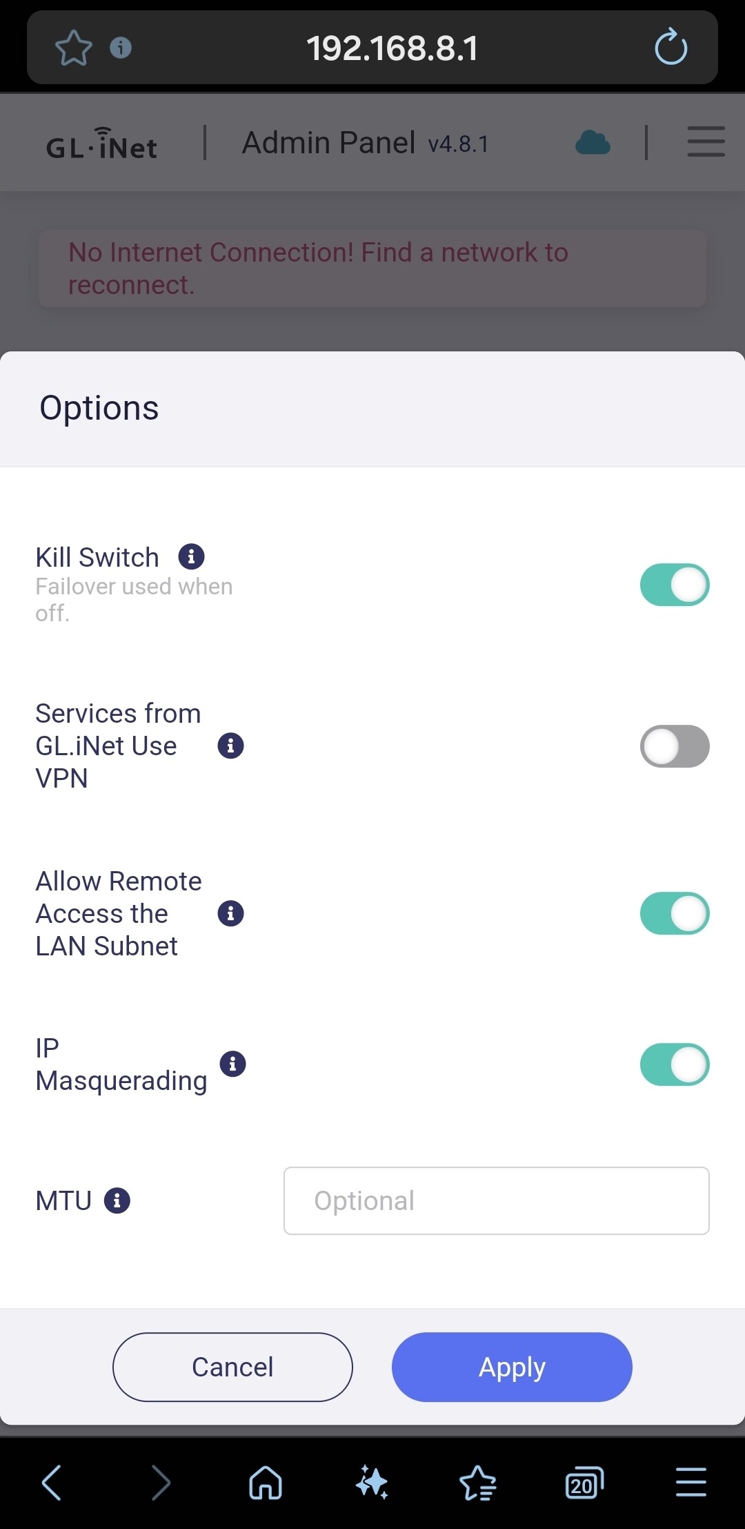

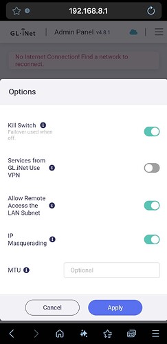

I've tried the above but unfortunately did not help. Please see tge attached screenshots.

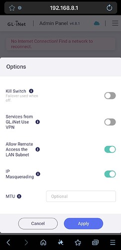

Hello VTURM,

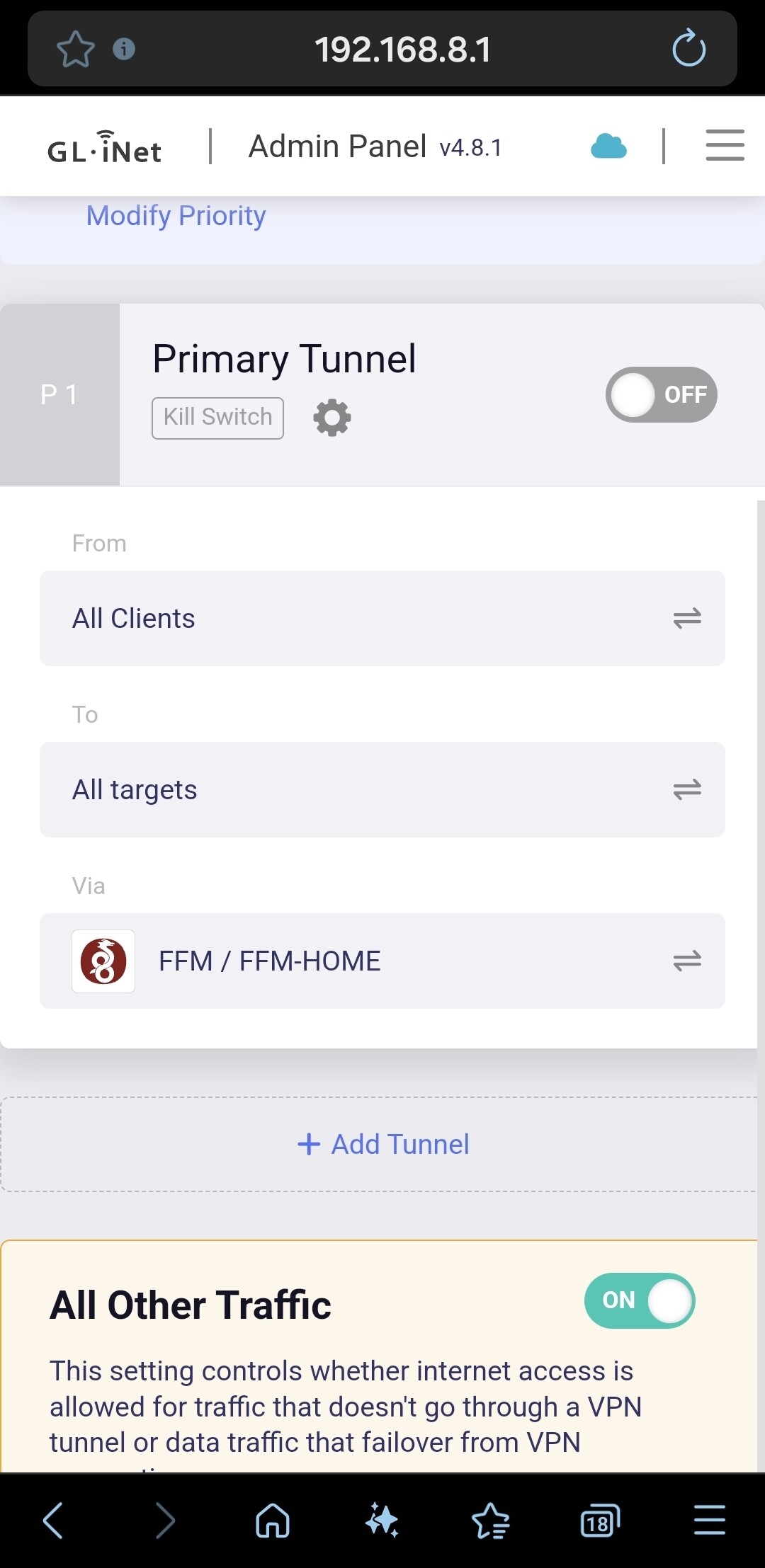

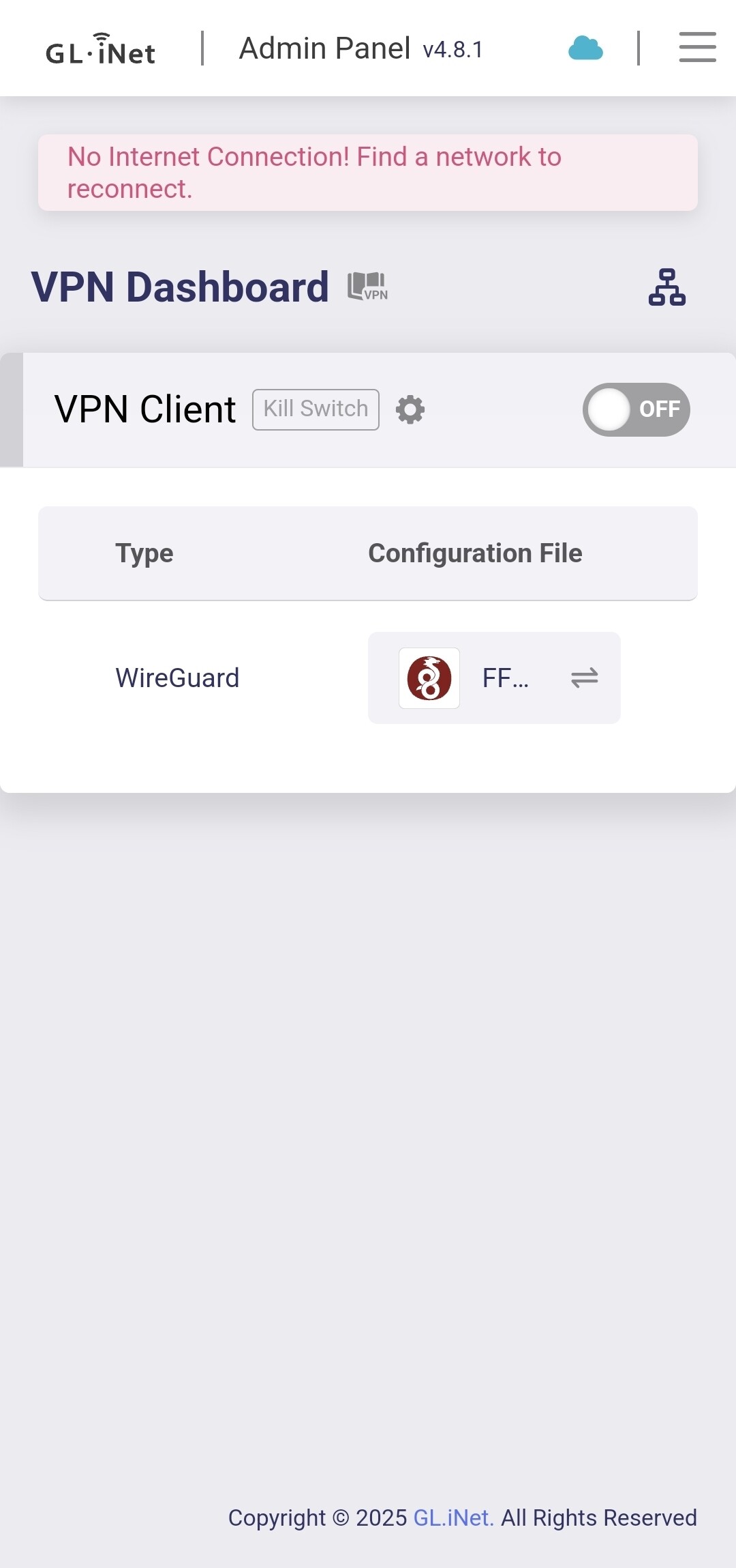

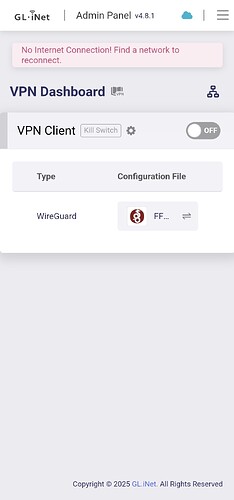

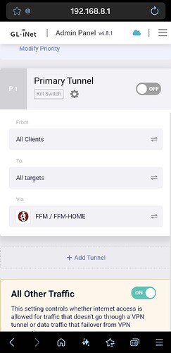

as I can see in your screenshots, you´ve changed the kill switch at the VPN Dashboard. This is not what we´ve meant. At the bottom of the Dashboard there´s an option “All Other Traffic”. Please disable all VPNs and enable this option.
Best regards,
routinator
Hey,
Im sorry, but probably I'm looking in tge wrong place, but I couldn't find this option. I tried the APP and also the web browser.
V

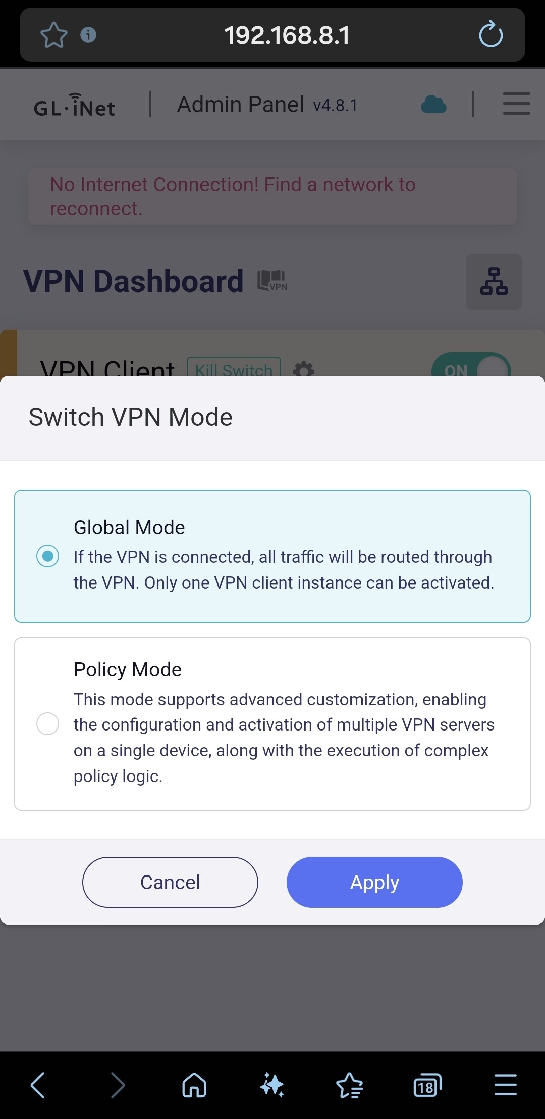

Ah, ok…. My router works in policy mode. Please, can you change to from global mode to policy mode?
I tried but it didn't help.

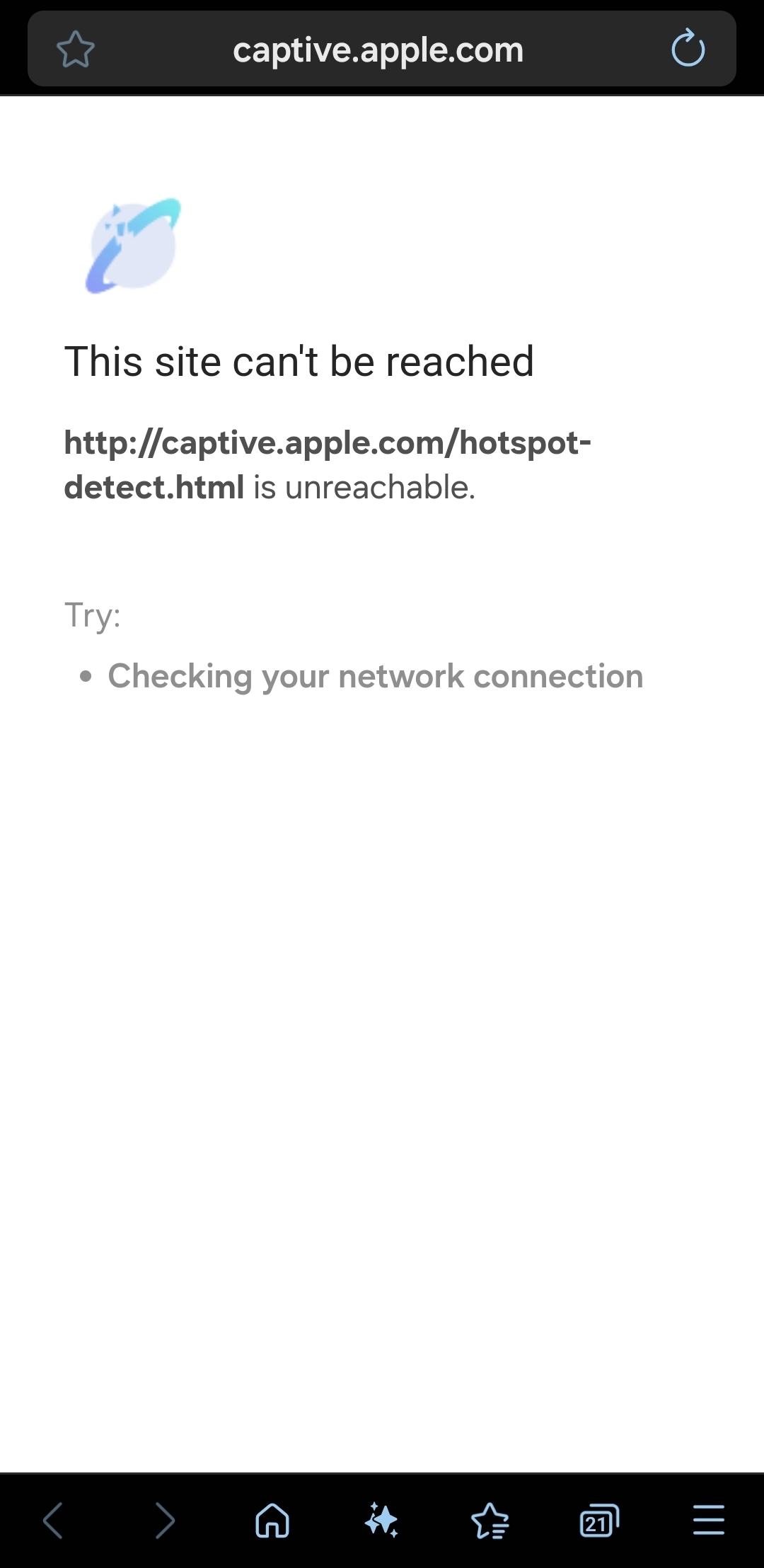

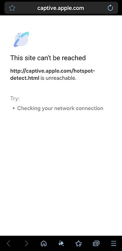

Please try downgrading the firmware and check:
  1. After downgrading, and SSH
curl -v 'http://captive.apple.com/hotspot-detect.html'
  1. After upgrading v4.8.1, and SSH
May I know which previous one firmware version works fine?
