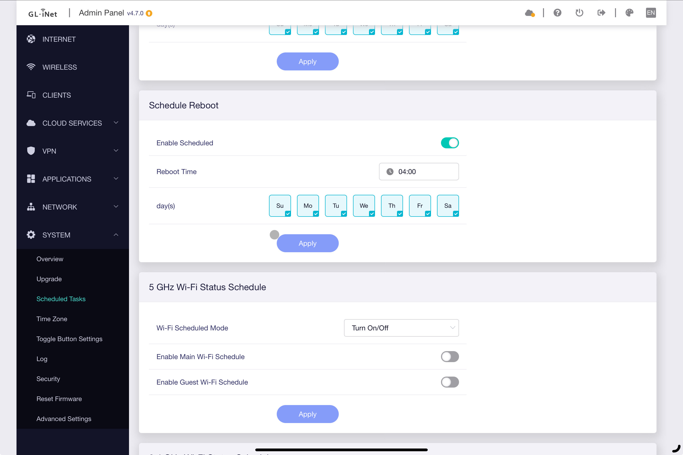

I set my Beryl AX to reboot every night at 0400. There is an admin panel option to set up the reboot. See screenshot.
The reason I set up the nightly reboot is because of repeated experiences similar to what you describe. Beryl AX seems to simply give up after a while - regular reboots are the only reliable solution I have found.

Currently the router can enable the schedule reboot.
Thank you both for your advice. After checking the Tailscale Admin Console often, I finally caught the Beryl AX online, logged into it remotely, and rebooted it. I also setup a scheduled reboot while I was at it. All seems to be back to normal at this point as cameras are streaming to my NAS. Great tip for the scheduled reboot!
