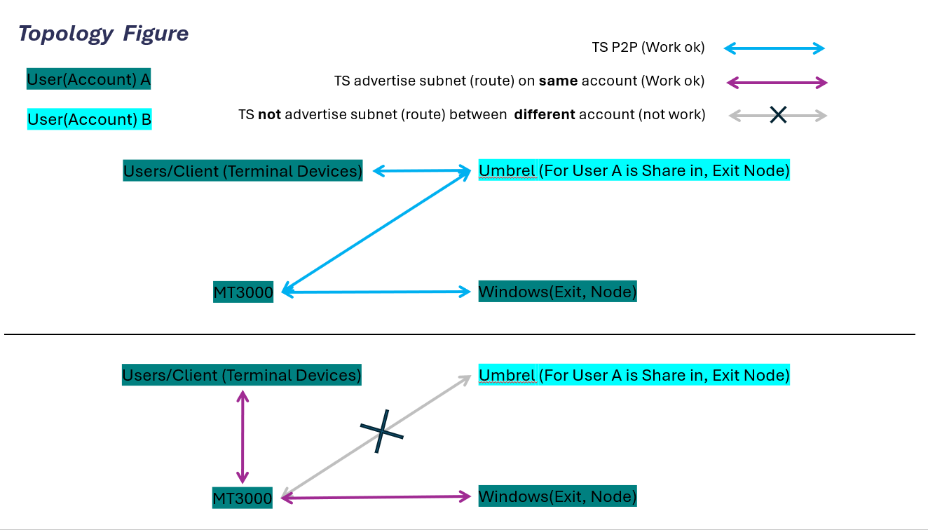

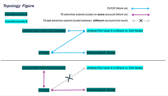

Base on your topology:
the share in exit node belongs to TS (Tailscale) User 1, NOT is User 2, and MT3000 login User 2.

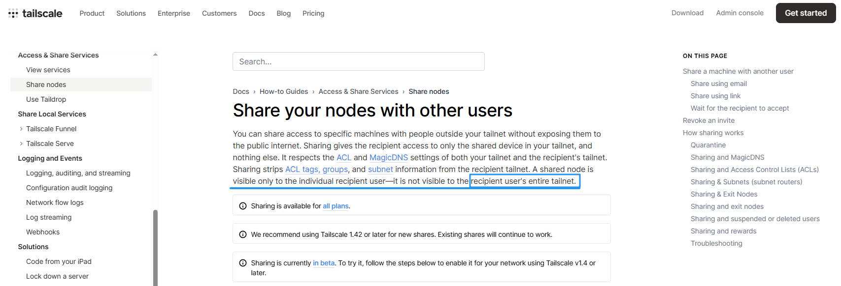

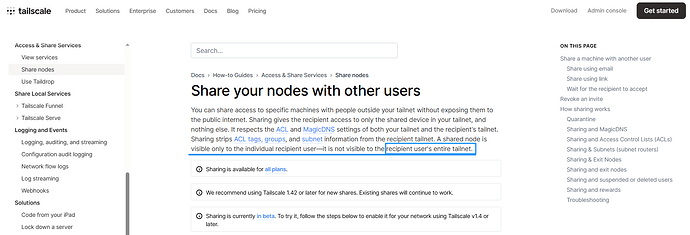

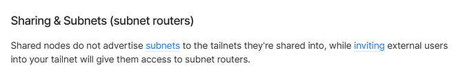

As we learn to TS (Tailscale) official docs, and find that said:
the TS does not advertise route between User 1 and 2
In the users/client which below the MT3000, share in exit node cannot work?
Cause TS does not share the subnet of the MT3000 between account user 2 and user 1, subnet also said the LAN of MT3000, so Umberla does not know the LAN of MT3000, but Umberla know the MT3000 TS interface, so only MT3000 can access the Internet with Share in Exit node via MT3000 TS interface -> (TS User2 Cloud -> TS User1 Cloud) Umbrel TS interface -> Internet (tested by ssh of MT3000 at my side), but the lower user/client which below the MT3000, these devices are in subnet (LAN) of MT3000, as the TS User 2 and 1 does not advertise route, means Umbrel does not know routing table, so these subnet devices link have problems, cannot link to the Umbrel of User 2.
Why can the user/client (terminal devices) access the Internet via the Umbrel? Cause they are installed TS client applications and create the TS interface self, and there is not subnet, all data pass by the TS interface directly, as well as the MT3000 (not subnet/LAN, only MT3000 itself) can work via Umbrel.
