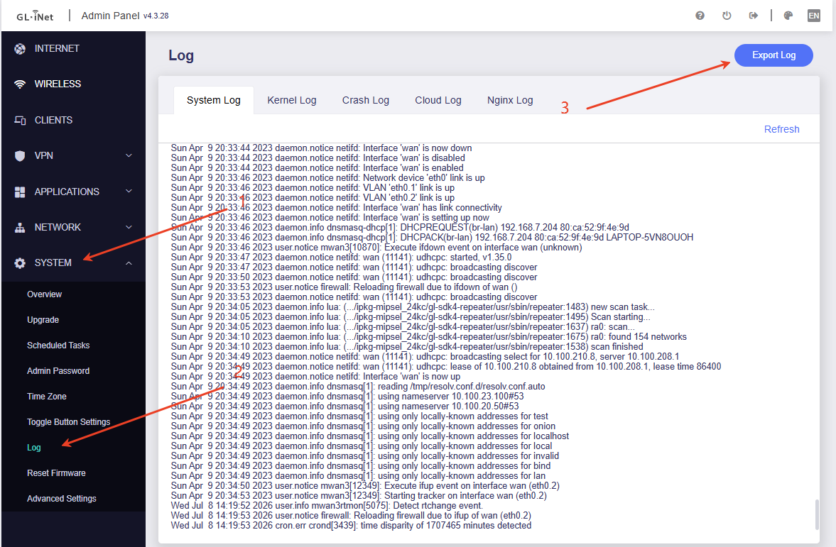

When the issue happens again, could you please export the router log from System -> Log -> Export Log and send it to us via private message?So we can check the VPN and network events around that time.
