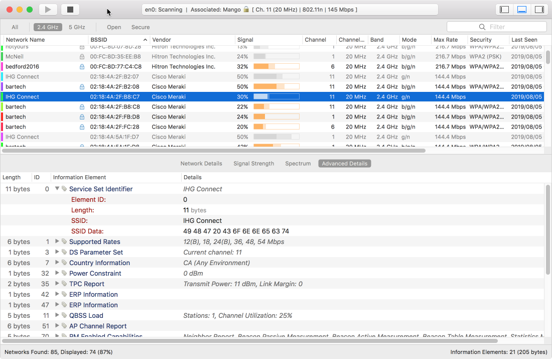

For example, on Channel 11, WiFi Explorer shows:
IHG Connect on Meraki:2F:B8:C7
bartech on Meraki:2F:B8:C8
Here’s a screenshot of the Advanced Details pane for the above IHG Connect beacon on Channel 11. Note that the SSID is not hidden, which has been suggested by others as being the root cause of Mango’s difficulties in finding these radios.

It’s apparent from the Cell 12 report that the Mango found the bartech beacon on the Meraki radio at 02:18:4A:2F:B8:C8. But it did not find the IHG Connect beacon 02:18:4A:2F:B8:C7 coming from the same base station on the same channel. The signal level is the same, the SNR is the same. But the Mango scan of ra0 doesn’t find it.
My next troubleshooting step was to do a site survey using the iwpriv apcli0 command:
Note the two highlighted lines. The 6th record from the bottom reveals the bartech radio on channel 11 (Meraki:2F:B8:C8). The 7th record from the bottom is the IHG Connect beacon (Meraki:2F:B8:C7), but the SSID is blank.
I think it’s evident from the WiFi Explorer results that the SSIDs of the IHG Connect radios are not hidden. The reason that the Mango router can’t scan & then associate with them is something else. I suspect it might be related to the fact that the Cisco-Meraki base stations are configured for multi-SSID operation. That might be tripping up the Mango WiFi stack.

I’ve done a little more digging, and examined the Advanced Details of the two SSIDs, as captured by the WiFi Explorer utility. There are some other differences evident between the two SSIDs.
The bartech SSID is configured for 802.11b/g/n.
IHG Connect only supports 802.11g/n.
There are differences in the “HT Operation” information element, subset 2 of 3.
The bartech parameter is 0x0004. The IHG Connect parameter is 0x0015.
Here are the details of this information element.
bartech:
IHG Connect:
