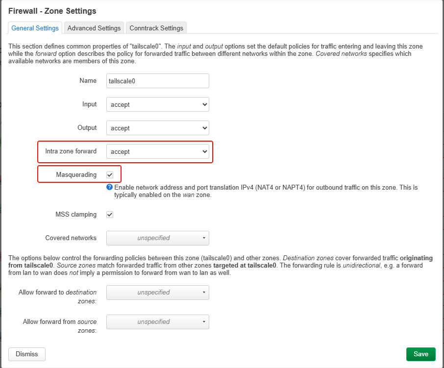

  2. Try modifying the Firewall rule of tailscale0:

Try modifying the Firewall rule of tailscale0: enable masquerade
