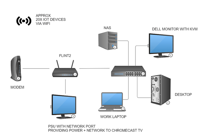

It’s only after getting home yesterday evening, trying to troubleshoot, that I disabled Adguard and the network instantly came back to life. I did this over the LAN connection via my Desktop’s browser: Desktop <> Switch <> Flint2 <> Modem
As my Desktop connected to the Flint 2 whilst the network was down, this issue must be linked to the Flint2 to WAN bridge/connection.
Wired network diagram:
