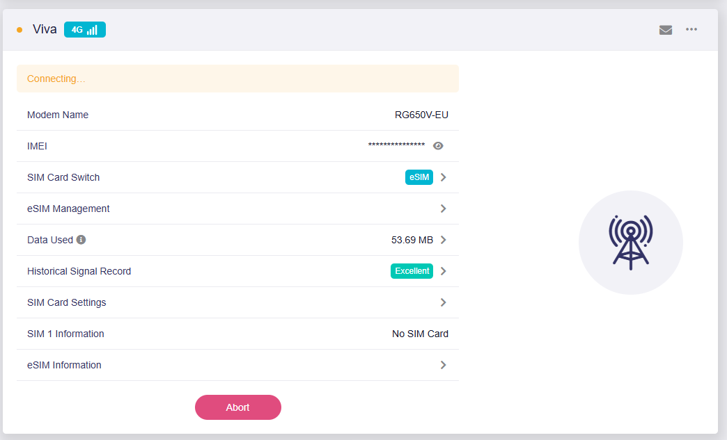

With cellular as the WAN, the data session drops after a period of inactivity and the modem does NOT re-establish it. The UI stays on "Connecting…" indefinitely until a manual action (re-applying the APN, Abort, or reboot). Observed and logged repeatedly over several hours. APN
"plus" is correct and connects fine — this is a recovery problem, not a setup problem.

  3. The carrier deactivates the session; the UI shows "Connecting…" and does not recover until a manual config change/reboot.

  1. Modem state DURING the failure (UI showing "Connecting", Viva, LTE, signal Excellent):

On the Mudi 7 this does not happen. After the carrier deactivates the idle session, the modem does not re-dial even when client traffic resumes. It stays on "Connecting…" until a manual config change (re-applying the APN), Abort, or reboot, as detailed in the logs above. This
