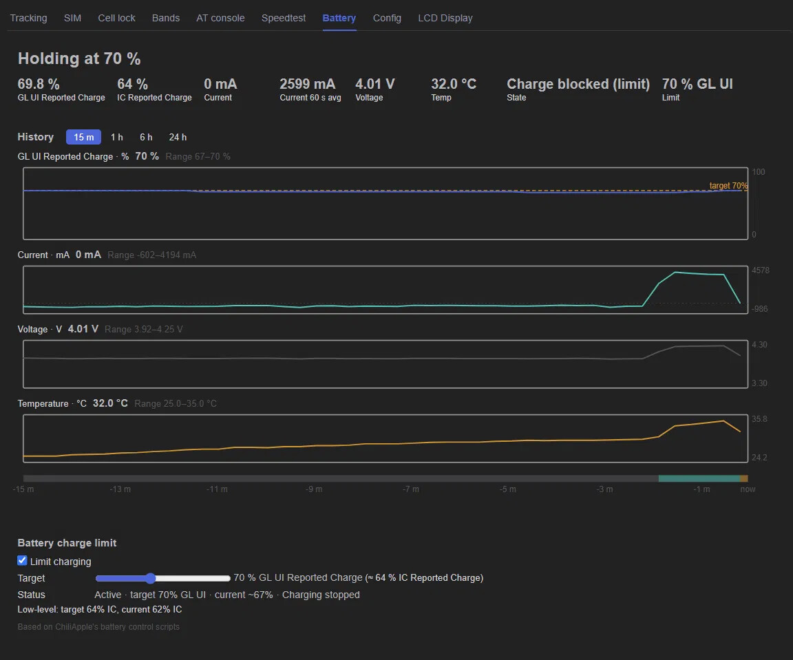

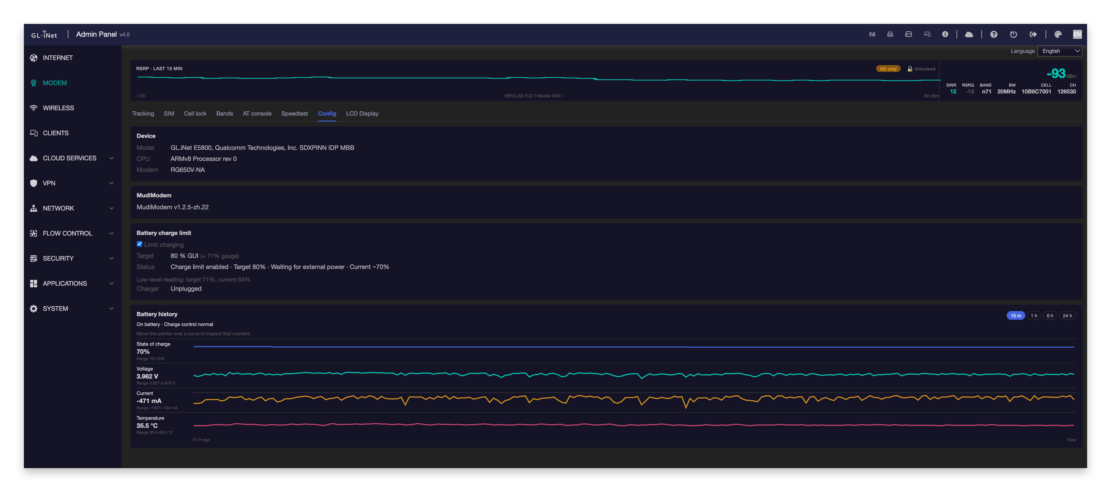

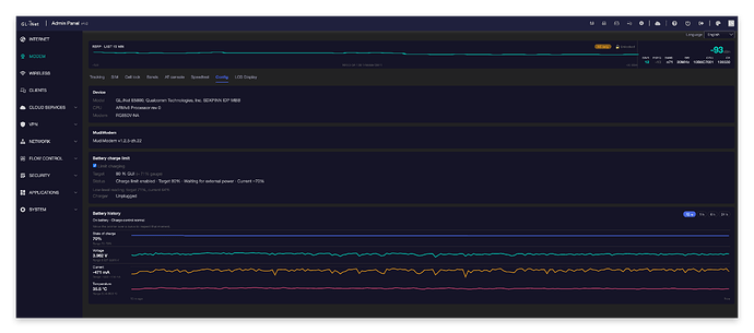

I I have added the battery history.
Hi daijie198, I also added a battery graph, but I like the look of yours better. Can you send it as a pull request or seperate branch so I can incorporate your graph?
HI @jnunez , I looked at this. Where would you recommend we place that information in the UI?
GitHub - jayck88/MudiModem at jayck88-patch-1 · GitHub Hi Kevin — I put my battery-chart implementation and related reliability fixes on this separate branch. The patch file is jayck88-battery-chart-reference.patch; feel free to cherry-pick or adapt any parts you like.

@daijie198 I incorporated your graph into the battery graph page, and it’s wired to the background data collection daemon. I tried to replicate as faithfully as I could, take a look. BTW, how did you get a dark background in the GL UI?
