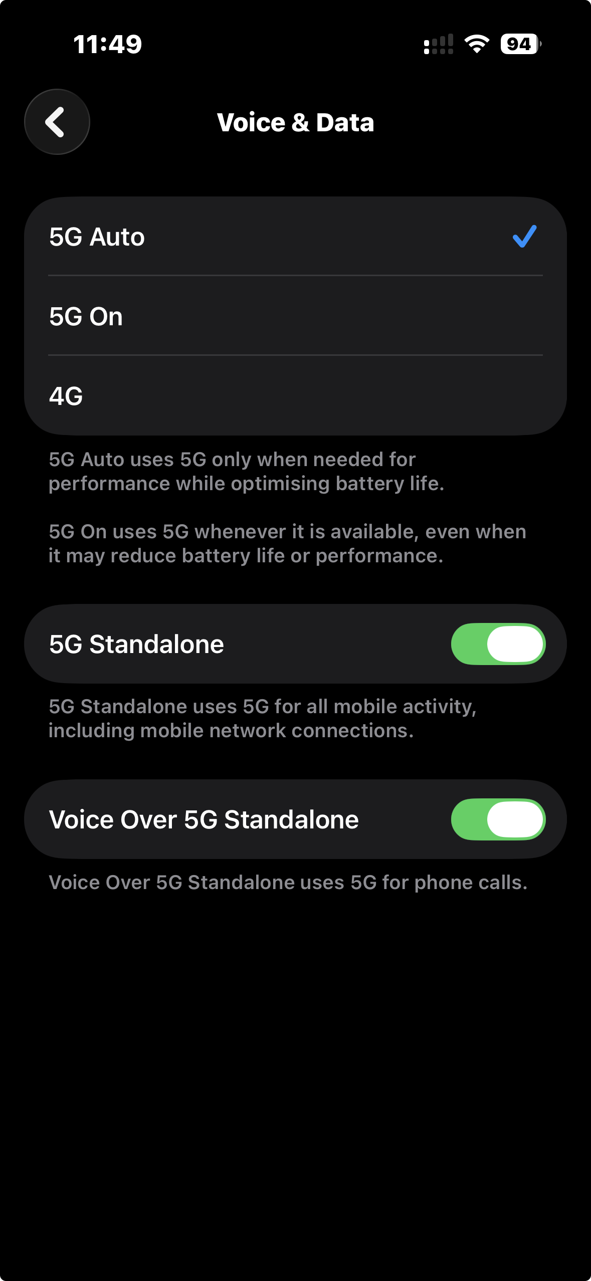

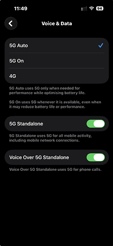

EE SIM in iPhone shows toggles enabled for 5G Standalone and 5G Voice over 5G Standalone thus the SIM is provisioned for it

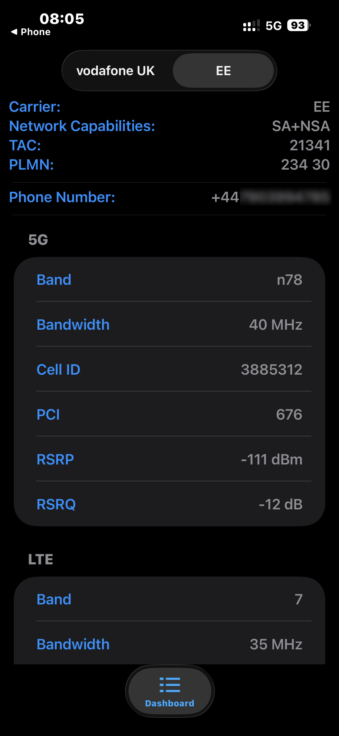

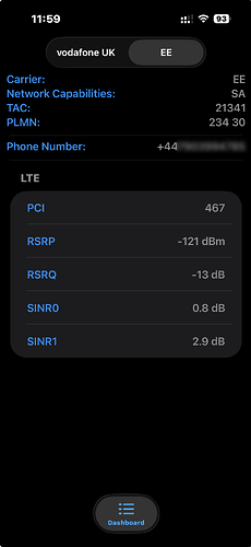

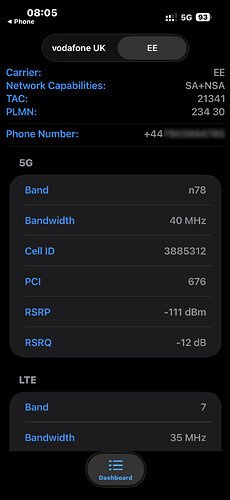

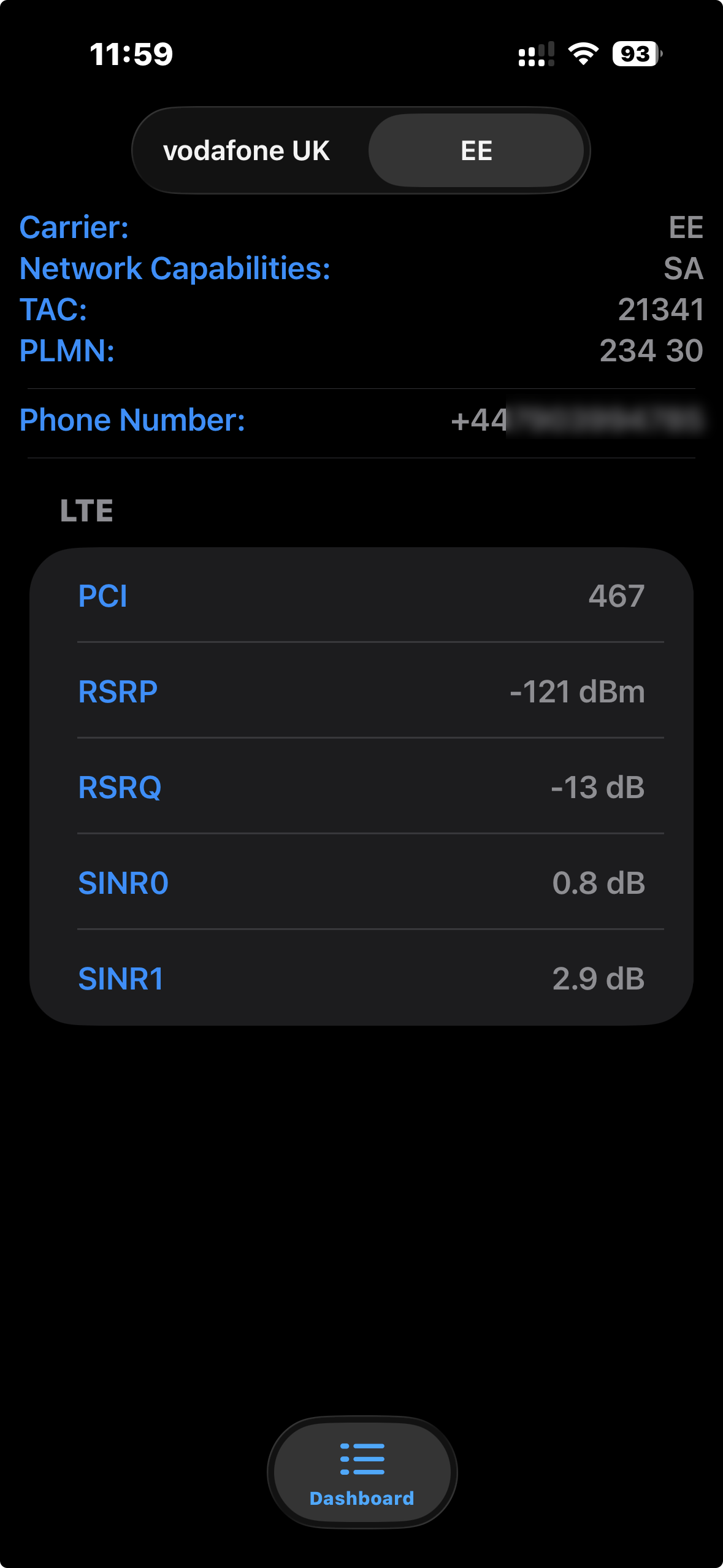

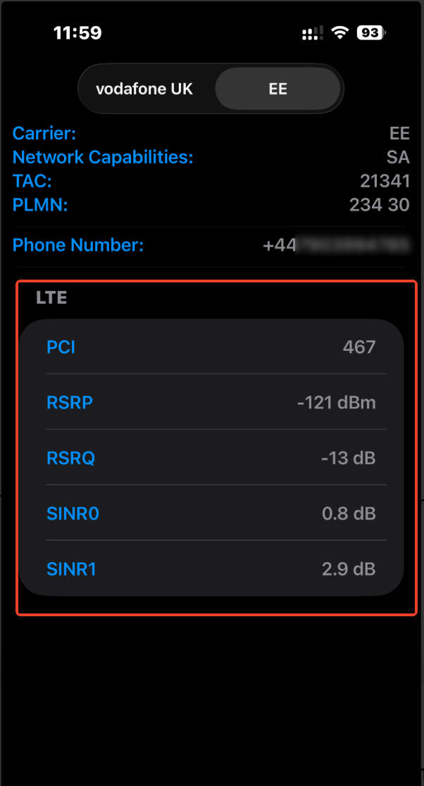

Could you share a photo to show us the cell info (e.g. cell id, frequency bands, etc) on the iPhone? This information can be found by dailling *3001#12345#* on the iPhone.
The dashboard toggle not working on ios26 to bring up other info
EE SIM tested in iPhone 15 Pro.

The circled part of the image shows the EE SIM card is currently on LTE, not 5G
Please turn off the Wi-Fi on the phone and re-enter Field Test Mode to check if it will connect to 5G SA at your current location. If it connects, we'll then look into the router's settings
Field test mode now showing SA + NSA with 5G n78 and LTE which looks very much like NSA 5G.

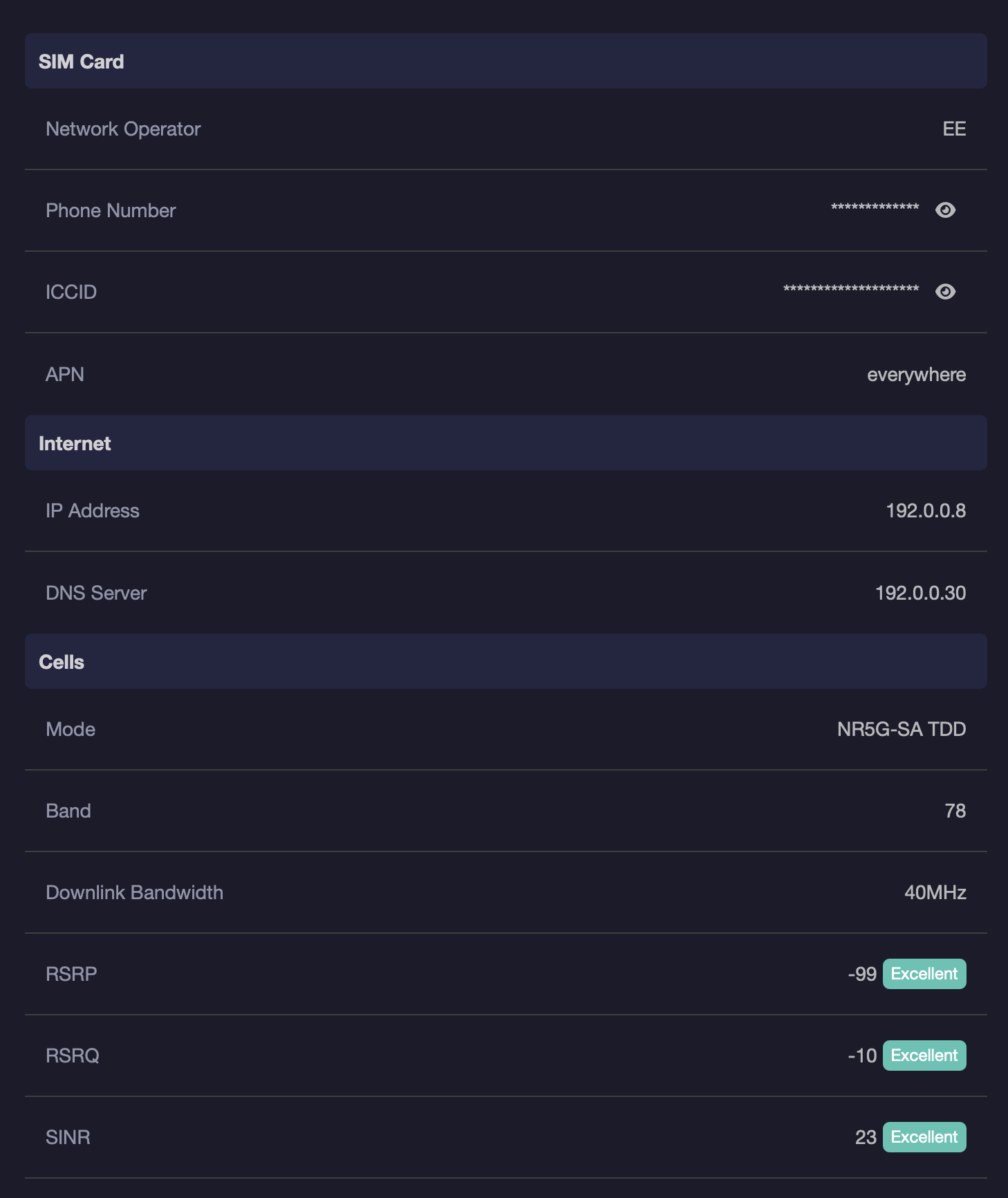

to followup:
New EE account with esim on “All-Rounder” plan now correctly showing 5G+ SA.
It seems that some sims provisioned prior to this year do not have SA entitlement and only certain higher priced EE contract plans have it added.
