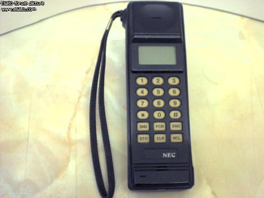

I don’t think I’ve ever had a mobile phone (and I’ve had them since my first brick NEC 9B) :joy: or a PDA (Palm Pilot 100) that when it is turned off and plugged into the power turns itself on?
Normally if it’s off then it shows a battery charging indicator only.
Normally if I’m plugging in the Mudi it would be to charge it up only. As I say if youre not aware of this you may find the Mudi flat when you really want to use it.
Yes. Android phones only start up partially, into their battery charging mode. You need to hold the power button to power it on. I personally think the Mudi should also be turned off. It can show an indicator on the screen that it is charging, but not have the router features on at all.
