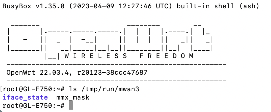

Can you check the device to see if this file exists?
Not sure about upgrading with a reserved configuration. What does that mean?
Also, what command should I be running or where can I find this file? Is it
ls /tmp/run/mwan3
Or something else?
You can run the ssh [email protected] command to access the background of the router
This is the output I get

This is what I see
Your upgrade process is v3.217->v4.3.9->4.3.12?
I don’t recall the starting FW but sounds about right
