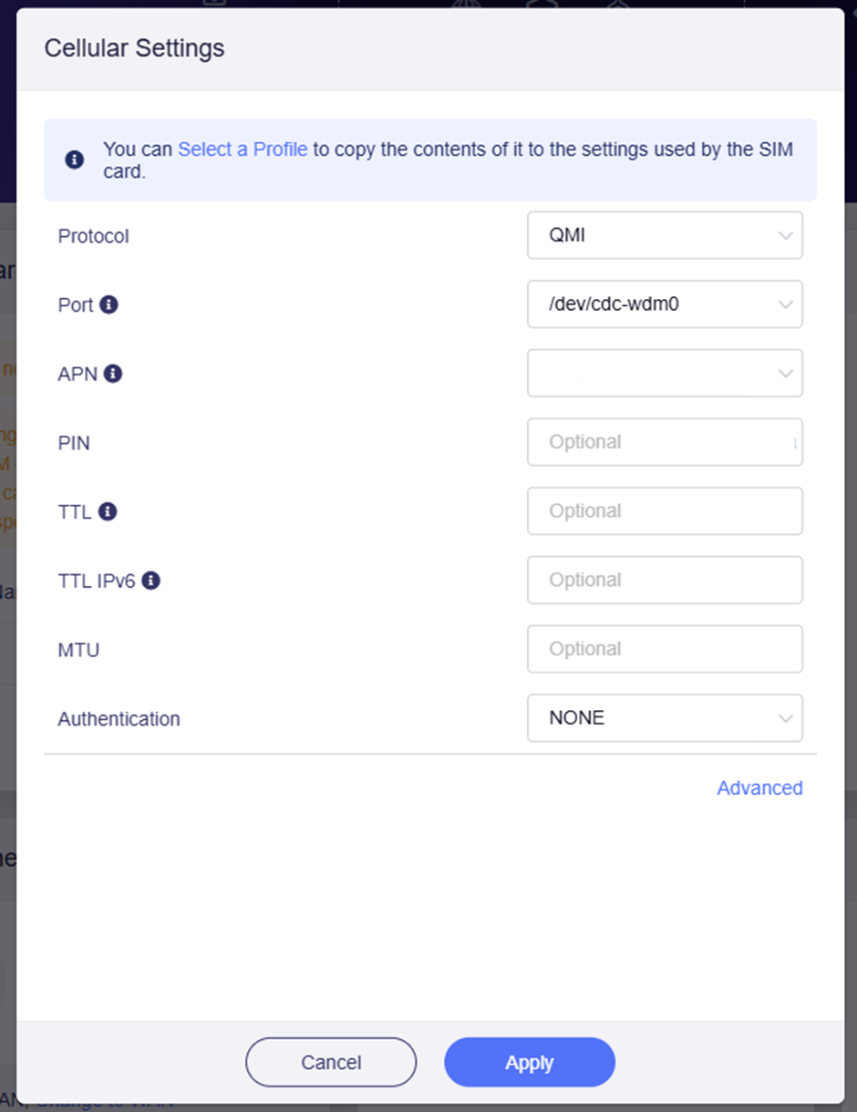

Hi Cathy, Ah I did have that enabled , but was playing with the settings and must have accidentally disabled prior to taking the screenshot.
I will resend a new set of screenshots when I arrive back to my hotel
Cathy, This is working now that I changed QCM settings, but it still does disconnect every now and then, but I'm not sure if that is because of the esim provider or not. Thanks for your help.

Oof that sounds super frustrating :downcast_face_with_sweat: if the SIM works fine on your phone but not on the Mudi, maybe it’s just not reading the APN right or something with compatibility. Did you already try popping in a different SIM just to test?
My brother and I worked on this for a while. We were using a GigSky United States plan, and it will automatically switch between ATT, T-Mobile, and Verizon. So once we cleared the APN, it started working perfectly (after a few min of course).
