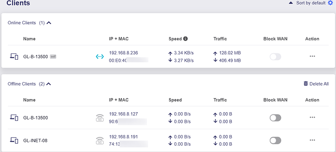

@bruce, I was able to establish a "WiFi" connection as you suggested. I had misplaced the USB C cable to connect to the Mudi Incidental Adapter, luckily I found another USB C cable that worked.
I was testing the Mudi V2 to see if I could monitor traffic through Linux Terminal to do some pentesting at home, but I wasn't able to get it to work for this. I was actually doing the testing when you replied.
