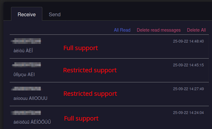

Now I had time to test things. Here's a screenshot:
Explanation:
I sent diacritic letters which are common in my language. Then I sent diacritic letters which are commonly used by providers in my country to meet the restricted charset to aware of the limitations. Before I sent the messages I changed the charset on the sender phone. As you see the issue comes up when I sent the messages with restricted charset support. This encoding issue only appears on the router. Phones are not affected. So it is not something provider related.

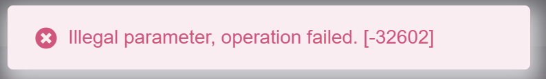

Hello @ViBE
The module parameters and the web GUI are incompatible after using the AT command AT+CPBS and AT+CPBW. Therefore, you can't send message and get error "Illegal parameter"
AT+CPBS="ON"
AT+CPBW=1,"+001234567890",129,"My Number"
You can revert it to normal using the following AT commands:
AT+CPBS="ON"
AT+CPBW=1
Similarly, the phone number being displayed as garbled text is also a incompatibility.
problem. Thanks
