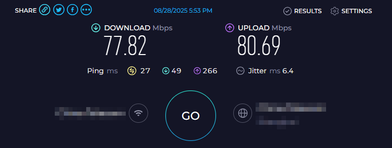

I decided to measure in every way my Mudi V2 after the poor cellular experiences and I just realised that this router does not even capable to provide at least the half of any advertised wireless speeds.
I connected it to my main router via LAN with a 1000/200 Mbps connection. Of course Mudi V2's switch is limited to 100 Mbps. That's clear. The goal was to reach this speed at least through Wi-Fi.
It is just one problem that the 2.4 GHz band is very poor, but the peak 5 GHz speed is as useless as the 2.4 GHz. This is the maximum what I can get no matter what configuration I use. Tested in every possible way, every possible combination.
No overlapping routers in my area. All of my client devices/hardware are AX capable. Intel AX201, Intel AX210, OnePlus 11 with a plenty of antennas.... Cannot even reach the 100 Mbps. Again. This is the peak. It's awful.

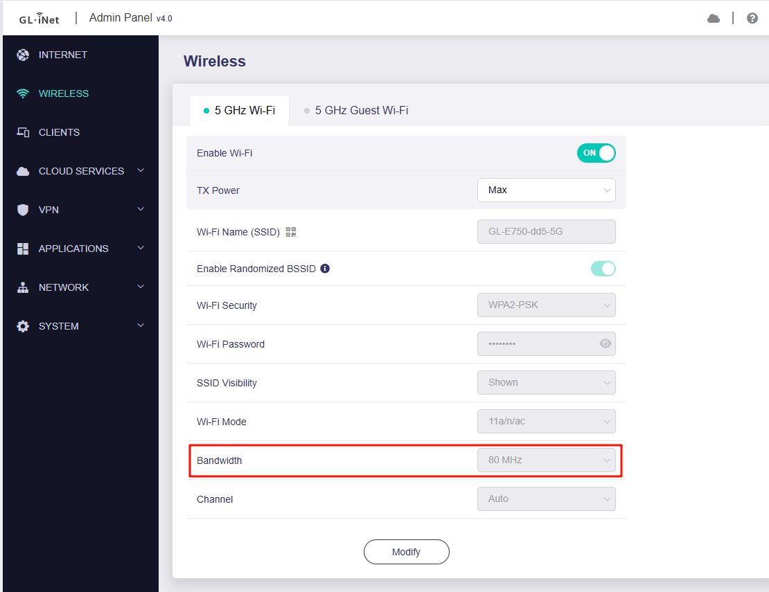

May we confirm whether you have changed the bandwidth of the 5 GHz SSID to 80 MHz, and whether your other devices are able to negotiate speeds of 433 Mbps?

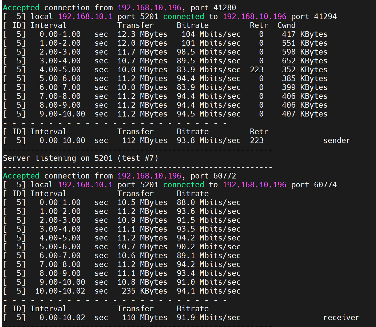

In our tests using iperf3 running on the Mudi V2, we observed approximately 110 Mbps download and 150 Mbps upload under Wi-Fi interference.

Tested with iperf and Waveform Bufferbloat test too just to be sure that this is not some kind of weird case with OOKLA's Speedtest. But all ended with same results. Then tried several settings. I also tested all encryption and all possible bandwidth settings. Just in case I tested again with the same settings as you asked:

In the iperf3 test environment:
iperf3 server <-- Ethernet connection --> Mudi v2 <-- Wi-Fi connection --> Client
We observed throughput of approximately 90 Mbps for both download and upload.
In the Speedtest environment:
Internet <-- Ethernet connection --> Mudi v2 <-- Wi-Fi connection --> Client
We observed throughput of approximately 80 Mbps for both download and upload.
During testing, we also noted that the Mudi v2’s CPU was operating at near full capacity.
This suggests that the observed speeds are close to the upper performance limit of the device when handling traffic through both the USB network adapter and Wi-Fi simultaneously.
