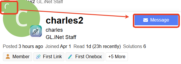

You can send the exported log file and the requested information to us via private message. This will help us review the details and continue troubleshooting.
