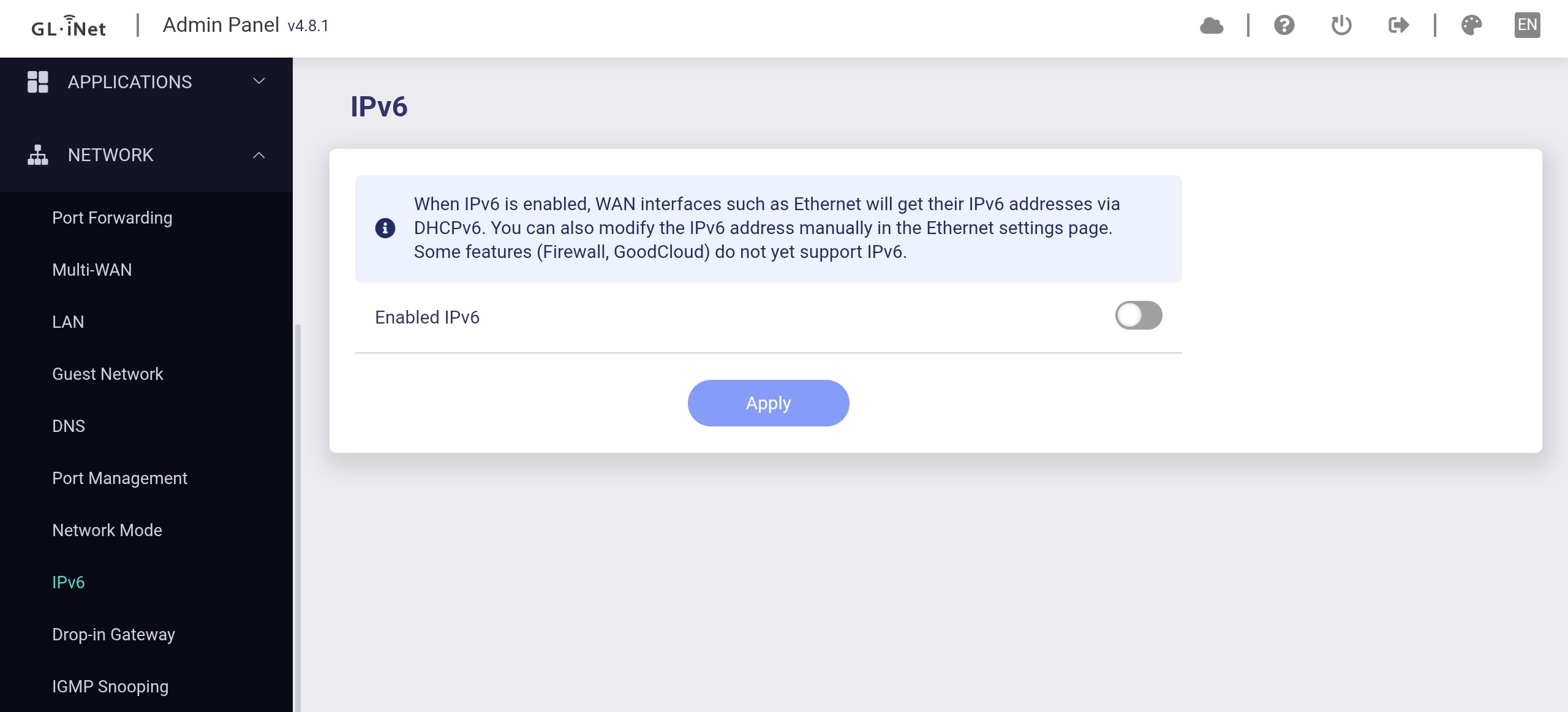

The GL GUI should have a toggle for disabling IPv6. For pure OWRT , if not most Linux distros, it can also be done at the kernel level. Reboot after applying:

I keep IPv6 disabled to avoid any potential leaks. The info blurb says the firewall doesn't support it.
The firewall absolutely supports it: uci show firewall | grep 'wan6' . Whether the GL GUI does is a different question. :wink:
