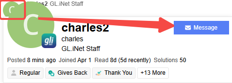

Thank you for the detailed capture and analysis.
You can send the .pcap file to us via a private message on the forum, and we will further review it and forward this issue to the relevant team for investigation.
