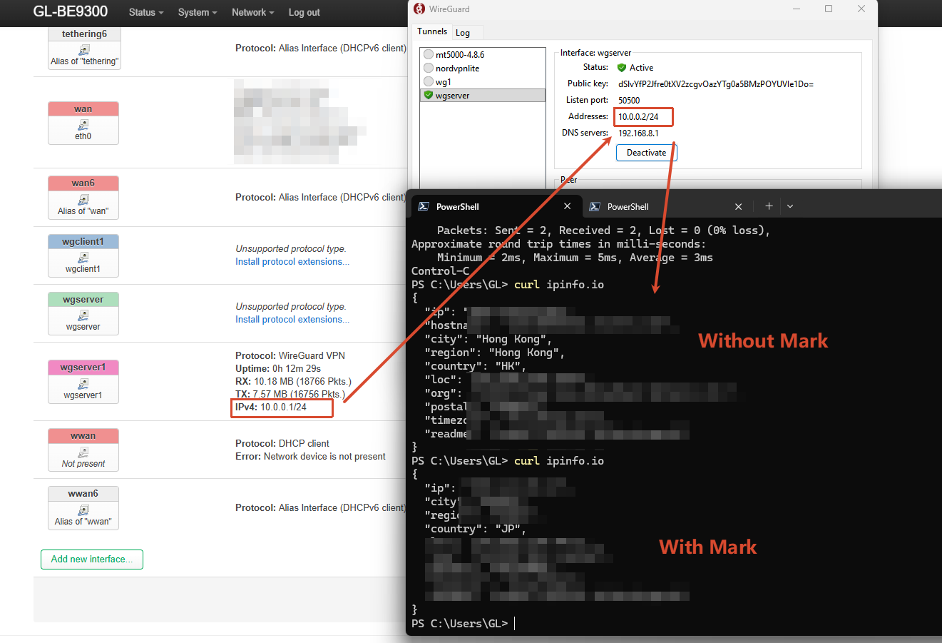

So I'm playing around with the new vpn dashboard, but I noticed that wgserver can only be single inside the gl ui.
So I decided to make my second wgserver instance with luci-proto-wireguard.
The tunnel works also for wan, but it fails for me when I want to cascade it to wgclient1 through the dashboard, I have tried various things including adding fw mark 8000 in my second wgserver instance, that seem to change behaviour from firewall drop to reject, the fw zone is forwarded to wgclient1.
Even when I lookup ip route I see a route that the second wgserver goes automatically over wan even though I explicitly unchecked peer routing in my peers so this seem to be added by something, if I manual remove this and make a rule so that the wgservers ip goes over device of wgclient1 it also fails.
I think I'm close to a working setup, but I'm missing a certain mark or table.

This is correct, basically I try to have a wifivpn from luci-proto-wireguard instance and then route over wgclient1.
I got it for wan working so the tunnel works, but it ignores when I set the policy for interfaces.

It seems it needs a little bit more configuration, it is now dropping connections, but wifivpn was not in the append_source_if list before, while in the ui it was set.
Edit 3:
After cleaning my orphaned firewall traffic rules with experimentation marks, the dropping behaviour was gone, however it just went through wan which is still unexpected.

Now what I don't know yet is if I need to touch config route_policy at all maybe only the rule is sufficient enough but as for now I have both setup and this works :+1::smiley:
