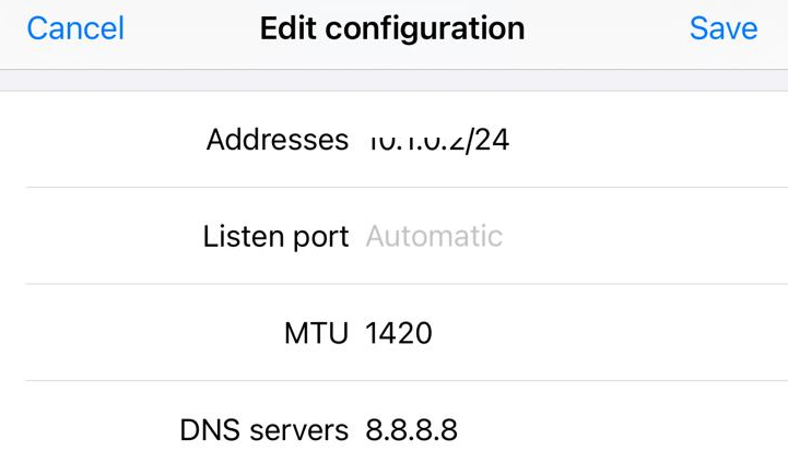

  1. Check Wireguard Client App - IOS
  • OK, Activated but still no Internet
Very strange config for server. In section Interface you must write "Listen port = " and this UDP port forward on main router. On Peer section you dont need take endpoint port, it may be randomly. Then AllowedIP 0.0.0.0/0 - you allready include all others IPs.
Also can you please post config of client without sensetive information.
WireGuard is a stateless technology, even if you see server work, it doesent mean anywhere.
The Wireguard client Listen Port is automatic. A random Listen port is generated after it is being set to Active Status. Are you suggesting to provide a static value ?

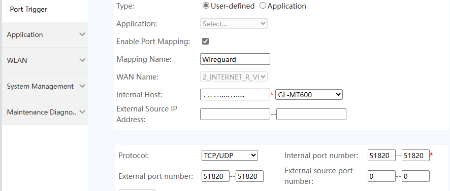

I’ve configured the main router to have UDP port forward on the internal host ip of my GL-MT600 with 51820 as the internal port number.

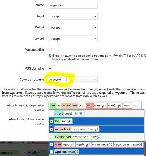

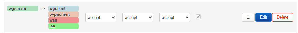

Check your firewall. Mine is like this:

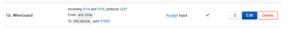

Thanks, i tried it but still am getting a “Handshake did not complete after 5 seconds” in my wireguard client mobile app log.
Below is the list of configurations I’ve made in the GL-MT6000 modem:
/cgi-bin/luci/admin/network/firewall/zones
*Note, unlike yours, I do not have an options to add: Allow forward to destination zones : wgserver
/cgi-bin/luci/admin/network/firewall/forwards
/cgi-bin/luci/admin/network/firewall/rules
I’ve also tried to delete and add back again the wireguard client profile just to make certain that the keys in the configuration file are correct. Likewise, restarted the wireguard server multiple times.

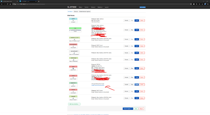

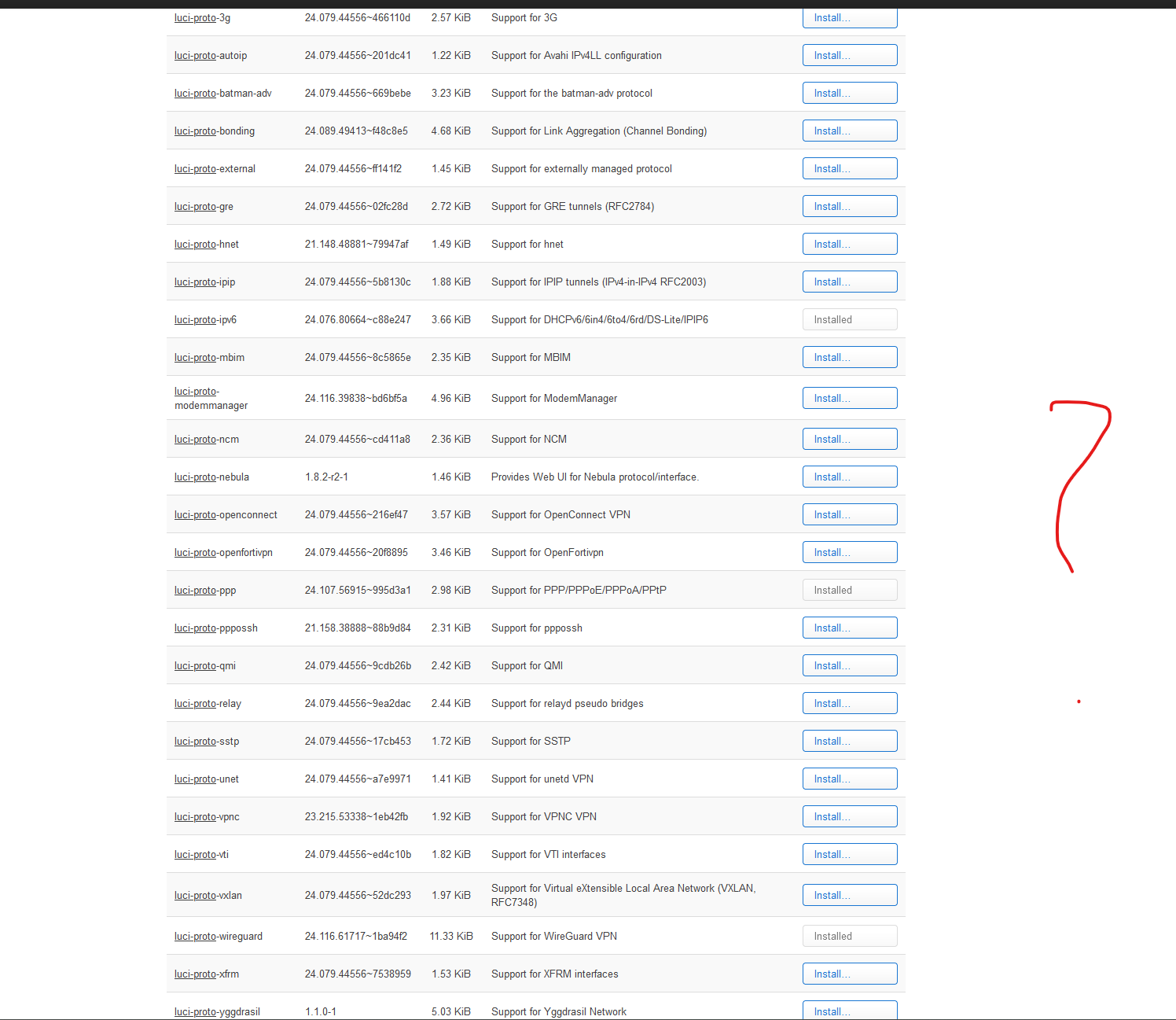

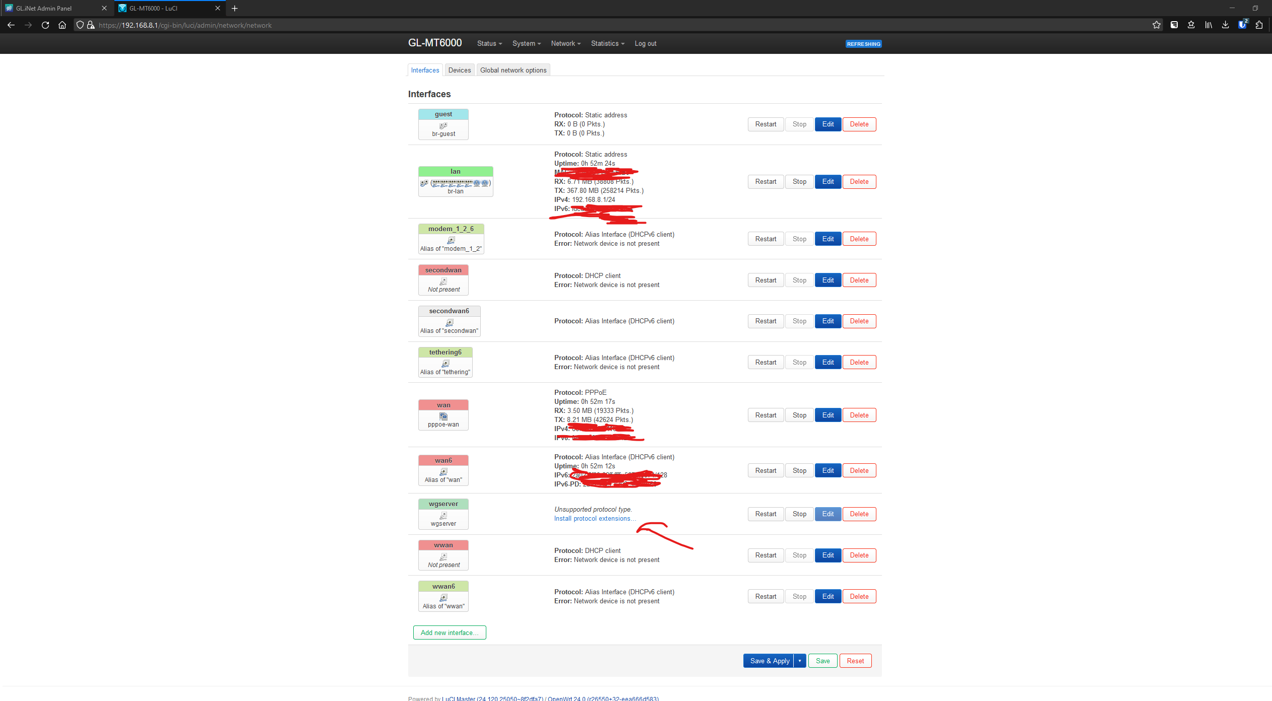

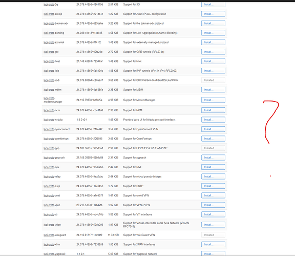

anyone know what package missing here?
No package missing.
GL uses some special connector to modify wireguard config - that's why "protocol not supported" is shown.
