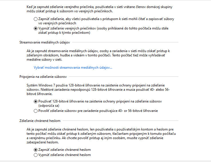

Check your Windows firewall.
advanced sharing settings
firewall
Is there anything set wrong?

I sent screenshots from the windows frewall. Could you check it if there is some problem?
