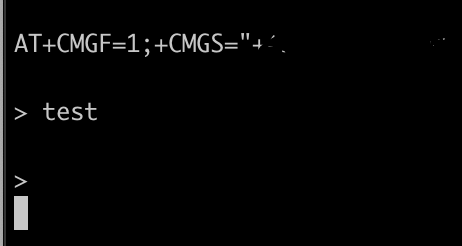

Yuo can concatnate two comands and forget about the seift thing! Syntax like this:
AT+CMGF=1;+CMGS=“+phonenumber”
then hit Enter ![]()
You need to restart both as I did!
I wasn’t lying about being fast
, now concatenated
Enable echo using the command I showed above and take a screenshot
Should be like this - notice the second command does not start with AT
then write your msg and hit CTRL+Z
minicom messed up my paste by adding dots instead of double quotes…
now it did work. *after typing it manually
