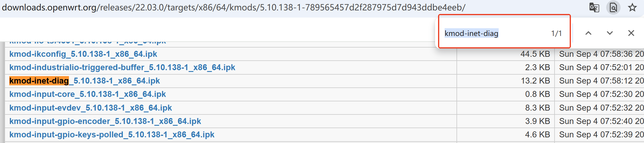

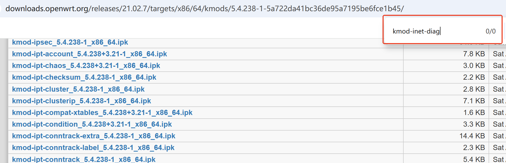

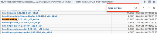

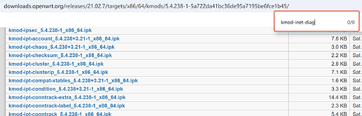

The OpenWrt package repositories we checked, it looks like the kmod-inet-diag package is not provided in the OpenWrt 21.02 package feed.
This package is available in newer OpenWrt branches, for example in the OpenWrt 22.03.0 kmods repository.
Therefore, if you need to use the komd-inet-diag on the XE3000, you may need to consider using vanilla OpenWrt.
