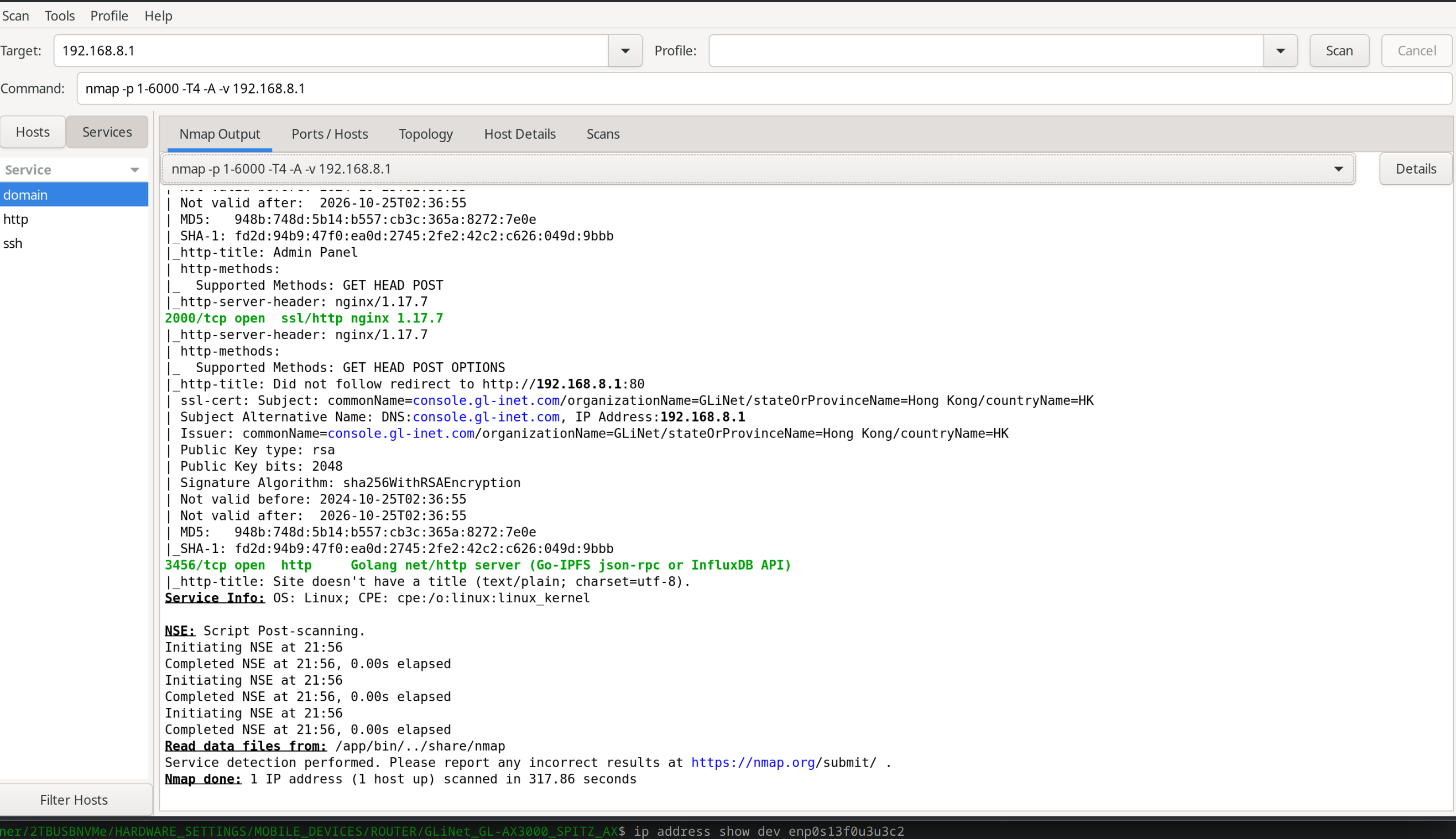

Anyway my router originally had two ports open, other than the regular 22, 53, 80, 443; these were 2000 and 3456.
I bought the router in March 2025 but the pepetrators got the leap on me at some point and it's been a nightmare as I'm not a computer wizard by any means. I thought updating via UBoot would be sufficient to remove any viruses but it seems not.
As soon as I could upgrade I did but I think I downloaded an infected .bin probably as they had poisoned my DNS. I downgraded from latest beta to v4.04 and then upgraded again to the latest beta. I managed to remove the open port 2000 but 3456 still remains open. I am on the latest UBoot, having just today updated, I then downgraded again to openwrt-x3000-4.0-0413r2.bin, still no change (i.e. port 3456 still open) and am now back on openwrt-x3000-4.8.0-0714-1752496086.bin.
How do I remove this?
I'm not ignoring the possibility this could be a supply chain attack but deleting all data and a number of firmware updates via UBoot have not got rid of this backdoor into my router.

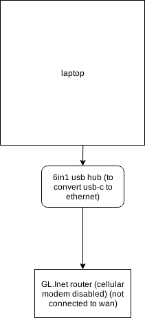

first I need to understand your network topology first, please use draw.io

Hi, OK my network is as simple as it could be.
So here is a drawing

I run zenmap to scan ports from 1 to 6000. The usual ports 22, 53, 80 and 433? (can't remember precisely) however 2000 was open and 3456 was open. The scan is run from my laptop with the IP number for the router targetted, i.e. 192.168.8.1.

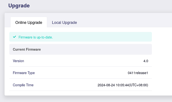

Update to my original post. I have obtained a brand new GL-x3000. I carried out the same scan on this. Port 2000 again is open, so this is open from new, and port 3456 is not open. So port 3456 is definatley a trojan of some sort but it seems impossible to remove.
So first question is why is port 2000 open on the new (box sealed) gl-x3000, bearing in mind when I updated to the latest beta firmware on my original router port 2000 is closed, i.e. doesn't appear in nmap after a scan.

If you look at the first picture of the nmap results I posted within the first post it shows the command I used, i.e. nmap -Pn -p1000-6000 192.168.8.1

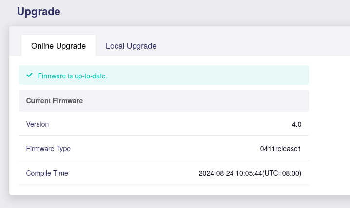

EDIT...ok just looking at the firmware of the new (sealed box router) scanned with port 2000 open is 4.0-0411r1

Right I have just re-scanned the brand new router and port 2000 does not appear as open so perhaps when I last scanned it I had some artifact on my computer that had caused it to appear as open.

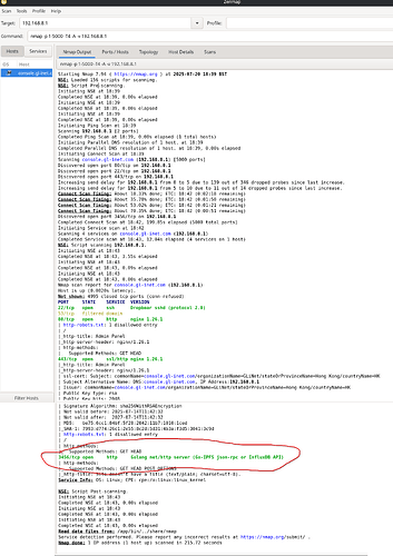

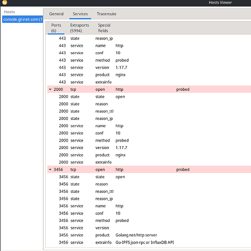

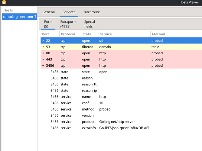

However I've re-scanned the old router and I'm learning a little more about zenmap and have discovered some sort of server keeping port 3456 open (tested on the lan side) not tested externally. Older firmware change via Uboot still reports port 3456 open and port 2000 also appears open. Why doesn't a Uboot update remove the virus?
Nmap scan on Firmware version
Nmap scan after downgrade (via Uboot) to Firmware version
Well, you've got something transmitting out on port 3456, that's for sure. Assuming that scan isn't reporting false positives whatever it is happens to be written in the Go programming language chances are more likely than not that's coming from your laptop.
(One really has to go out of their way to get a Golang 'app' to run on a SBC).
You can see what the router's processes are using ports on the router itself via netstat -natp. Eg:

Confirmed the port 3456 in GL firmware is used for the eSIM management feature.
15fbc5c9f706e2981df1a5ee42f56432
This port only open/listen on the LAN side, and is not open/listen on the WAN side, external from WAN cannot attack the device through this port.
About the port 2000 on LAN, I found the v4.4.13 is open/listen in first time initiations, but it is disabled in v4.8.0.
Please upgrade the firmware to v4.8.0.
The port 3456 is used for GL firmware feature, it is only on LAN, not WAN, please feel free to use.
