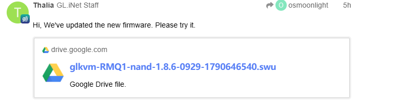

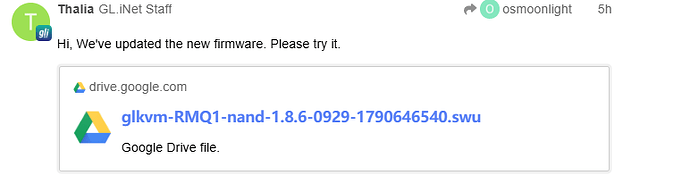

Hi, We've updated the new firmware. Please try it.

Hi, have you tried the v1.8.6 firmware we provided this morning? If not, could you please try it first and let us know if the issue still occurs?
Hello, sorry, my mistake. I had used the wrong firmware version (1.8.5). I have now used 1.8.6., seems to be stable for now.
