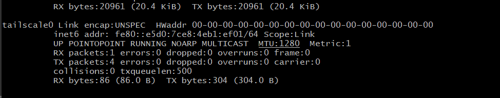

working well! I had the same issue after upgrading from 1.3.x to 1.4 beta1 as I did beta2, I had to reset the device for tailscale app to work again, it just hung and was spinning, overall everything is working as stable as 1.3 but with more features! jiggler back saving the day.
can you provide debug log(when it happened) to me ? I saw some user report this bug, but we can't reproduce it
Think I got the log this time, sent the zip to you.
It seems your Tailscale isn't bound at all. Is this the log from when the issue occurred?
I think I've figured out the issue. It appears that COMET cannot synchronize time via NTP - at least it couldn't when these logs were generated. This might be causing Tailscale's abnormal behavior. I can see both the connman process and ntp process are running. Do you have any firewall rules that might be blocking NTP protocol?Or your COMET can't access internet?
Nothing stopping it. This happened on both upgrades of 4, I couldn’t even pull the debug log when I first had the issue, the output was.
"ok": false,
"result": {
"error": "str",
"error_msg": "Error collecting logs: ZIP does not support timestamps before 1980"
When trying to get the logs exported, even with the time zone and such set
it has the correct UTC setting but the date/time was, Wed Dec 31 17:04:45 MST 1969 is the date output
After a reset it got right and I was able to proceed. This was coming from the latest 1.3 to the first beta 4, now the 2nd beta I was able to at least pull the log.
No rules or anything customized other than the display size.

I am having the same issue where I cannot use the tailscale feature.
please let me know how to i send the log files for your viewing.
the tailscale issue popped up for me after changing the EDID, and or after enabled/disabling the disc mount. It is all related to time. Each time tailscale was failing it was because the time was not being set. One key difference I noticed is I've had the cloud connect disabled. As soon as I enabled the cloud it sync'd the time and tailscale was working again.
I think there is a bug related to when it attempts to sync time, without the proper time it will not connect to tailscale
