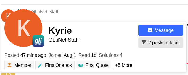

I don’t see the option to PM anywhere :face_with_diagonal_mouth:
Click on the profile image and then Message:
Here’s what I see:
