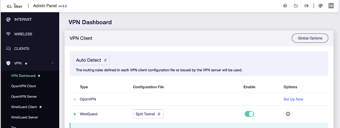

can anyone reproduce this domains not routable bug on 4.6.0 with VPN PBR enabled but VPN client off?

Reported a DNS leak issue with 4.6.0 Beta 3 and VPN Policy Based Routing here, affects stable 4.5.8 as well.
I'm running Beta 3 on my Beryl AX and I've noticed that when I run my Wireguard split tunnel VPN (which has DNS entries in the configuration), the DNS entries in Wireguard are not being used. I checked the DNS page and can see the DNS entries configured but instead my Wireguard connection is using the DNS from the Repeater instead. Will this ever be fixed? This does not happen when I configure all the VPN traffic to a full tunnel connection.
