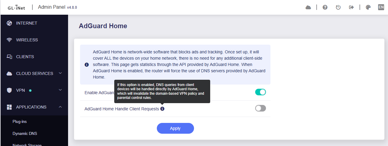

I haven't gotten to using Adguard Home on the Flint 2, but there is something that I think raises a concern, and maybe GL.iNet staff can help me understand what it means:
What does that text in the balloon imply?
If there's an invalidation of VPN policy, then isn't that what's causing the DNS leaks?
