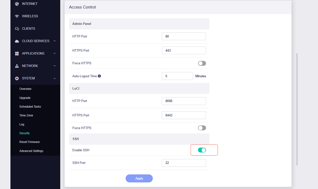

There's also a bit of an issue in the luci interface, I'm not sure if I'm the only one encountering it, in system > administration> 'ssh interface', checking or unchecking "Allow root logins with password" doesn't seem to work, hence ssh access doesn't work, changing manually '/etc/config/dropbear' fixed the problem.

hi, could you check if SSH is enabled?

My bad, ssh wasn't enabled.
