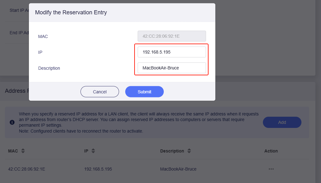

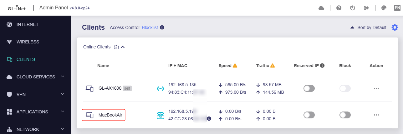

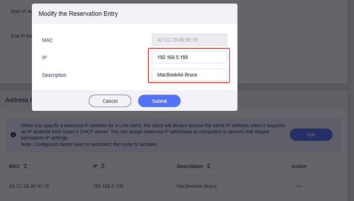

  1. I don’t Like that after Manually entering Client devices to LAN’s reserved IP, New client names, IP etc are Not showed up under Clients page (offline or online).
  2. On Clients page, there is No toggle switch to TurnOn or TurnOff WAN, LAN, Changing IP by simply clicking parts of IP address (after Reserve is On)

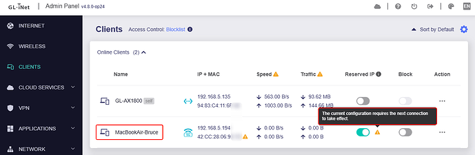

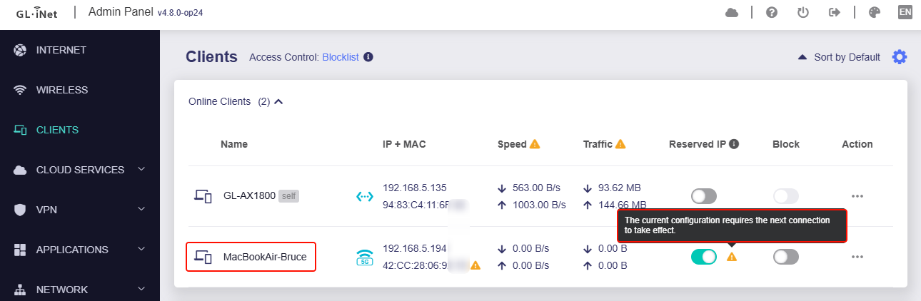

Thanks for your feedback.
  1. New client names have taken effect, BUT IP will take effect in the next connection of this client, like say that is DHCP renew.
  2. I think this is a good suggestion, will collect it to the PM team for evaluation.

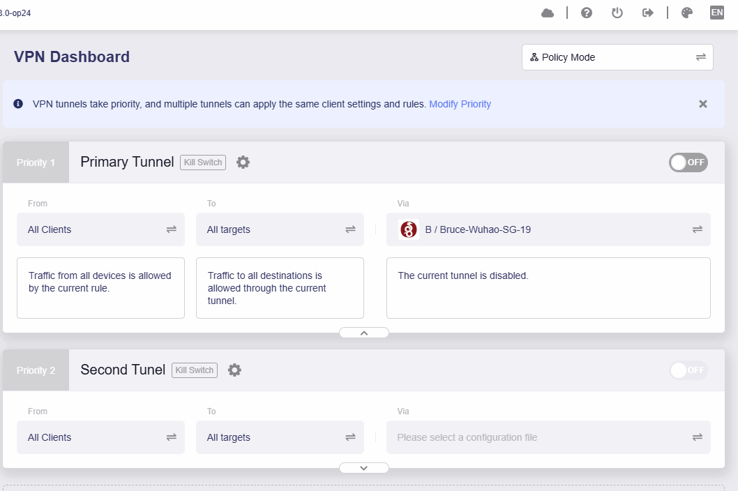

I think I found a bug concerning same server setups as multiple tunnels. I set up a VPN server for use by specific devices with priority 1 and kill switch enabled and the same VPN server as priority 2 for use for "all devices" (meaning all other devices without specifying them, in my understanding) with specific domain exclusions. The effect is that the devices affected by the priority 1 tunnel cannot access the internet while for the devices affected by the priority 2 tunnel everything works as expected. When I assign two different servers to each tunnel, both tunnels work as expected. So I guess I could just solve the issue that way, but isn't performance reduced by connecting to more than one VPN at the same time?
