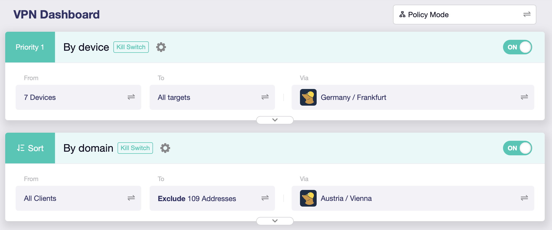

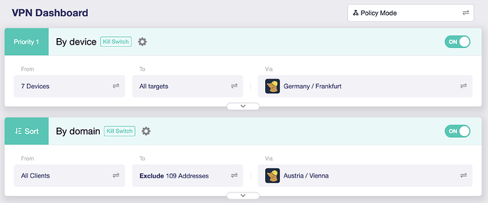

Could you please share screenshot for the your VPN dashboard?
This is a situation where:
  1. VPN server = SERVERNAME
  2. Certain specific devices access EVERYTHING - Tunnel1
  3. All other devices access only a subset of the Internet (domains 1.....N excluded).- Tunnel2
The picture is quite clear in my mind.
This setup works because the servers are different. If I set both tunnels to the same server the devices targeted in tunnel 1 lose their connection. It is 100% reproducible. Try for yourself.
Yes, my initial explanation was sufficient for someone to reproduce the bug. Maybe now that I provided an additional screenshot it will be done.

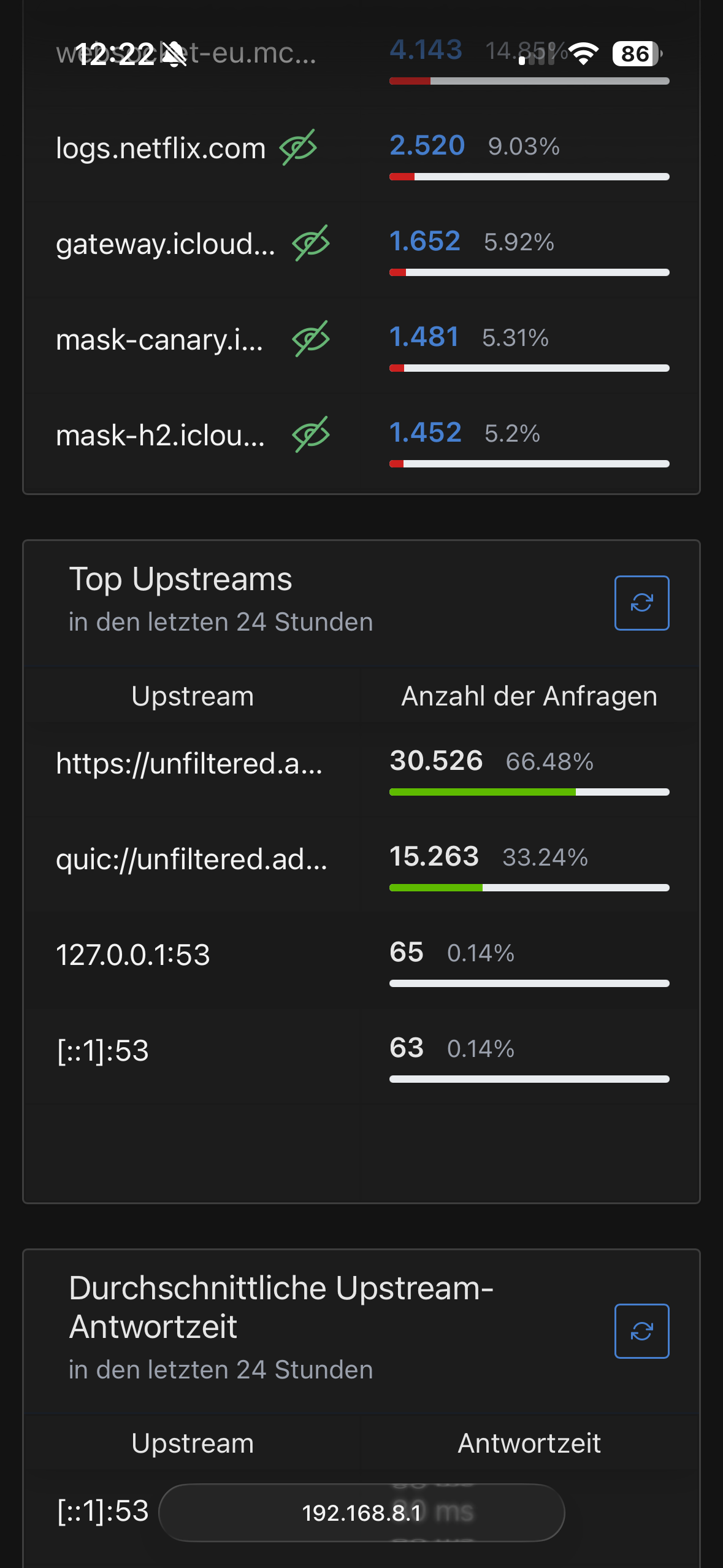

I think AG is reopening port 53. It happened right at the beginning with the beta. Now, with the latest snapshot, it's back. It has nothing to do with AG rebooting, as there have been 50 requests via port 53 in the last 24 hours.
