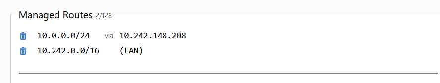

Did you create the routes inside your ZeroTier network?
For example it should like this:

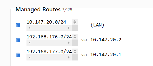

192.168.176.0/24 is one network of mine, 192.168.177.0/24 another. Since I added the necessary routes by the ZeroTier routers, I can access both networks just like they are connected to each other.
If 10.242.148.208 is the ZeroTier IP of your router, then it’s fine.

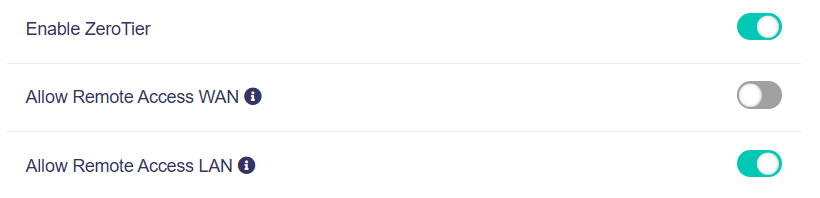

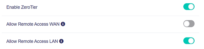

Make sure that Allow Remote Access LAN is enabled as well on your router.
