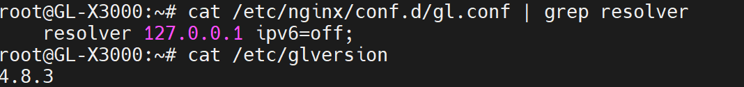

I needed to ssh into the router and edit line 24 in /etc/nginx/conf.d/gl.conf from:
resolver local=on ipv6=off;resolver 127.0.0.1 ipv6=off;
Then I tested that the configuration was working with:nginx -t and then I restarted the nginx: /etc/init.d/nginx restart
We tested using the X3000 running stable firmware version 4.8.3 but were unable to reproduce the issue.
Could you please let us know:
  1. The firmware version currently running on your device.
  2. If the issue started after an update, the versions before and after the upgrade, and whether the configuration was retained.
