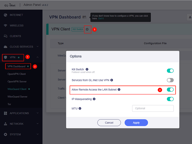

How to enable access to the MT6000 via a VPN tunnel. Which is in the same Firewall zone as LAN.
Could you let us know whether this option has been enabled?
If no, you may be unable to access the MT6000 and its LAN devices from the Intranet side.
But if it has been enabled, and you can access the LAN devices of MT6000, but cannot access to the MT6000.

the “Allow Remote Access the LAN Subnet“ is enabled.

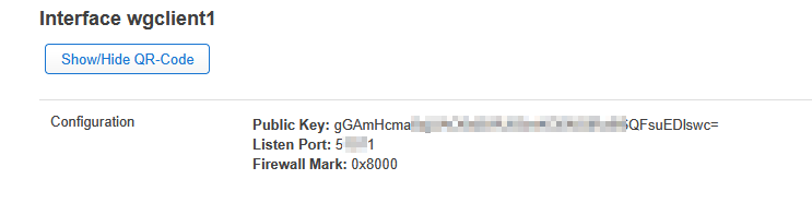

In the OpenWRT-Luci Gui i recognized a Firewall Mark: 0x8000 on the Wireguard Overview.
On our other Routers (AX1800) which are also connected to the same Intranet VPN, there is no Firewall mark.
