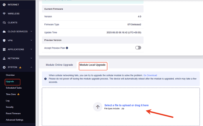

The module upgrade method for GL-X2000 is a bit different. You can reboot the router and upgrade it via the web GUI.
GL-X2000 supports to update the module from the GUI ->Upgrade->Module Local Upgrade

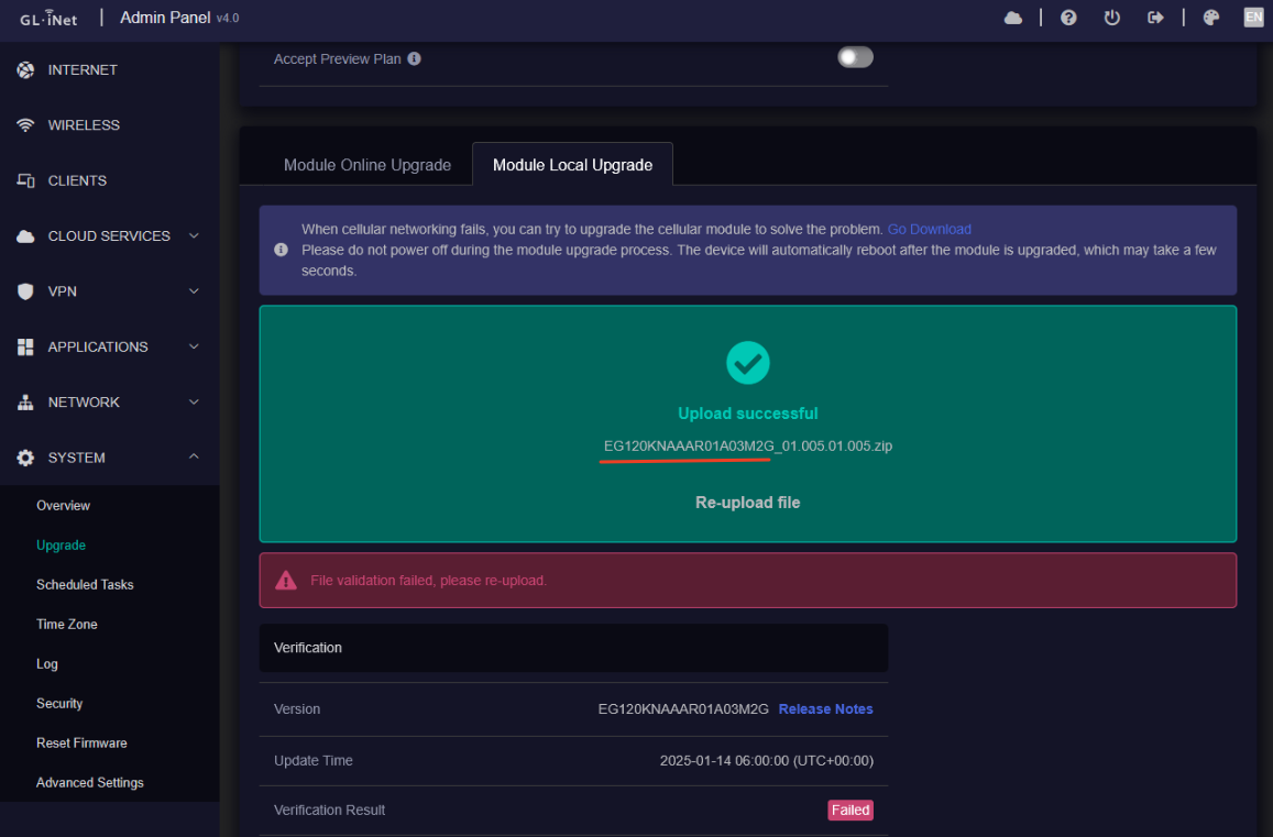

Thanks for the suggestion. I already tried upgrading through the web GUI, but it failed with the error:
Failed to upload file
So unfortunately I couldn’t proceed that way either.
Do you have any guidance on why the GUI upload fails, or an alternative method that works reliably for the GL-X2000’s Quectel module?

Was this resolved. I’m also experiencing the same problem on the X2000 I’ve bought. Error validating the file when I drag and drop. Have downloaded the latest firmware from glinet
Hello, this module firmware you uploaded is for module EG120K-NA, which is used for North America region
Please go to "Module Online Upgrade" page to check your router‘s module version and ensure you've downloaded the correct module firmware and retry.

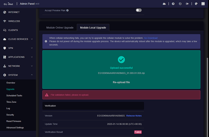

Sorry for the delay. I’ve sent you the log in a private message. Here is the message I get when I try to upload the firmware file through the GUI:
Thanks. The logread file seems not have records related to file uploads. Can you check again the current module version and the module firmware file:
  1. Go to the Module Online Upgrade to check the current module version
  2. Share a screenshot to show us the name and the size of module firmware that you want to upload.

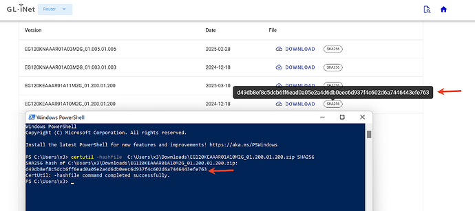

    Or if module firmware is downloaded from GL download center, use command to verify the SHA256 value. E.g., check the SHA256 value in Windows:

Confirmed that the firmware you updated is the original package which is for full update. However, the X2000 does not support full upgrade; it requires a differential upgrade for the modem module.
Please contact the Quectel for a differential package. Then update the modem module through web GUI or through SSH.

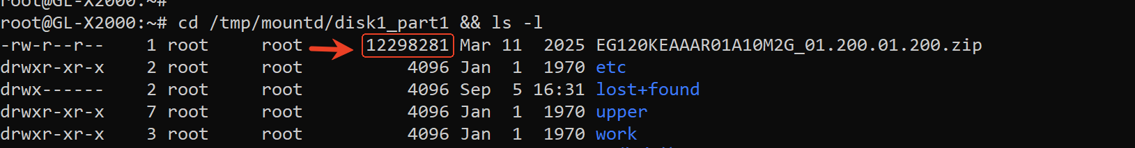

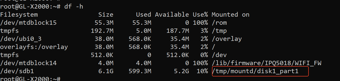

  2. Put the differential package to a USB drive and insert the drive into the router. Use command df -h to view the mountd path and record it
    Use the command below to check the differential package file size.
cd /tmp/mountd/disk1_part1 && ls -l

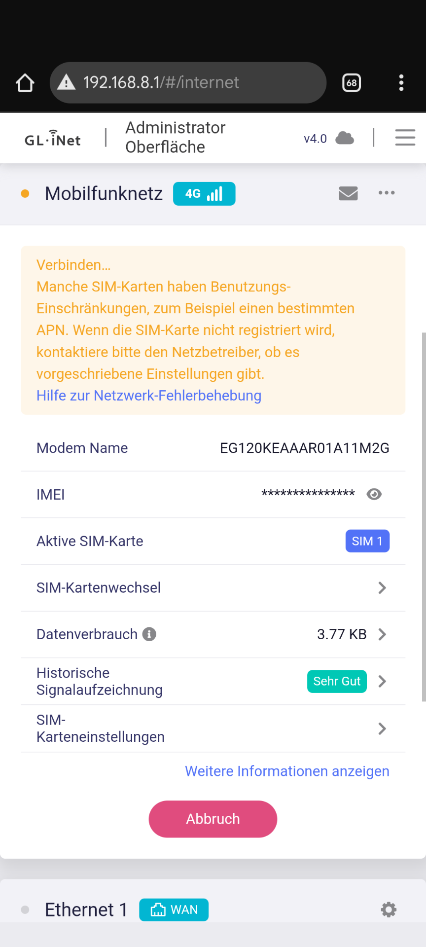

I have another issue with new Modem Software:
Used webui to update Firmware to latest Beta and Updates Modem Firmware to EG120KEAAAR01A11M2G.
I have 2 esim profiles in my eiot Sim and both wont connect anymore:
What can i do?
Hi, pls run the AT command AT+CGDCONT? to check whether the APN used by the modem is correct.
Click on ... -> Reboot Build-in Modem, select Soft reboot and see if it works
APN is correct and Sim was working on previous Beta. Maybe the Modul Software is wrong? But i cant find the Option to upgrade anymore in Webui…
Seems an Beta 4.8.2 issue (regarding other posts)
Whats the easiest way to get form Beta 4.8.2 to Stable 4.7.13 without loosing settings? Cannot install via WebUI, memory full??? Dont have any aditional packages installed

Sorry we are currently verifying whether it is bug of the beta firmware v4.8.
Please run the following command in the ssh terminal:
sed -i '71,85d' /usr/share/gl-ngx/oui-upload.lua ; /etc/init.d/nginx restart
Refresh the admin panel page. Then you can downgrade fw to v4.7.13 with keeping settings.
Confirmed current beta v4.8 has problems with cellular feature and need to be fixed
