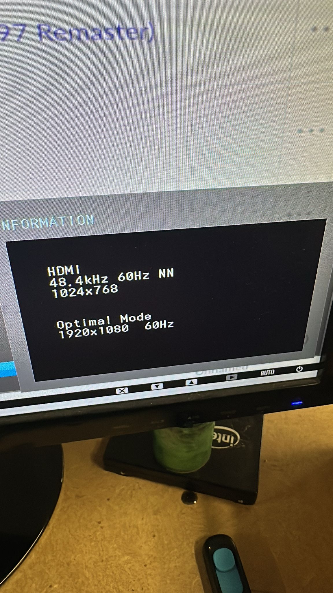

Physical monitors have no issue syncing to the output, and show the resolution at 1024x768x60Hz. See one example below:

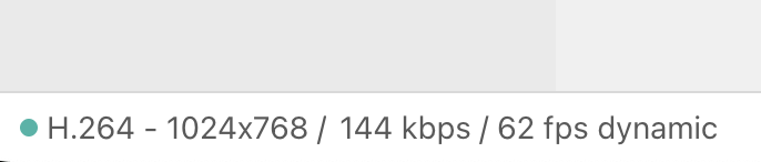

It works!! Thanks for the quick turnaround. Really appreciate that. Here is what the status bar says:
And log snippet:
