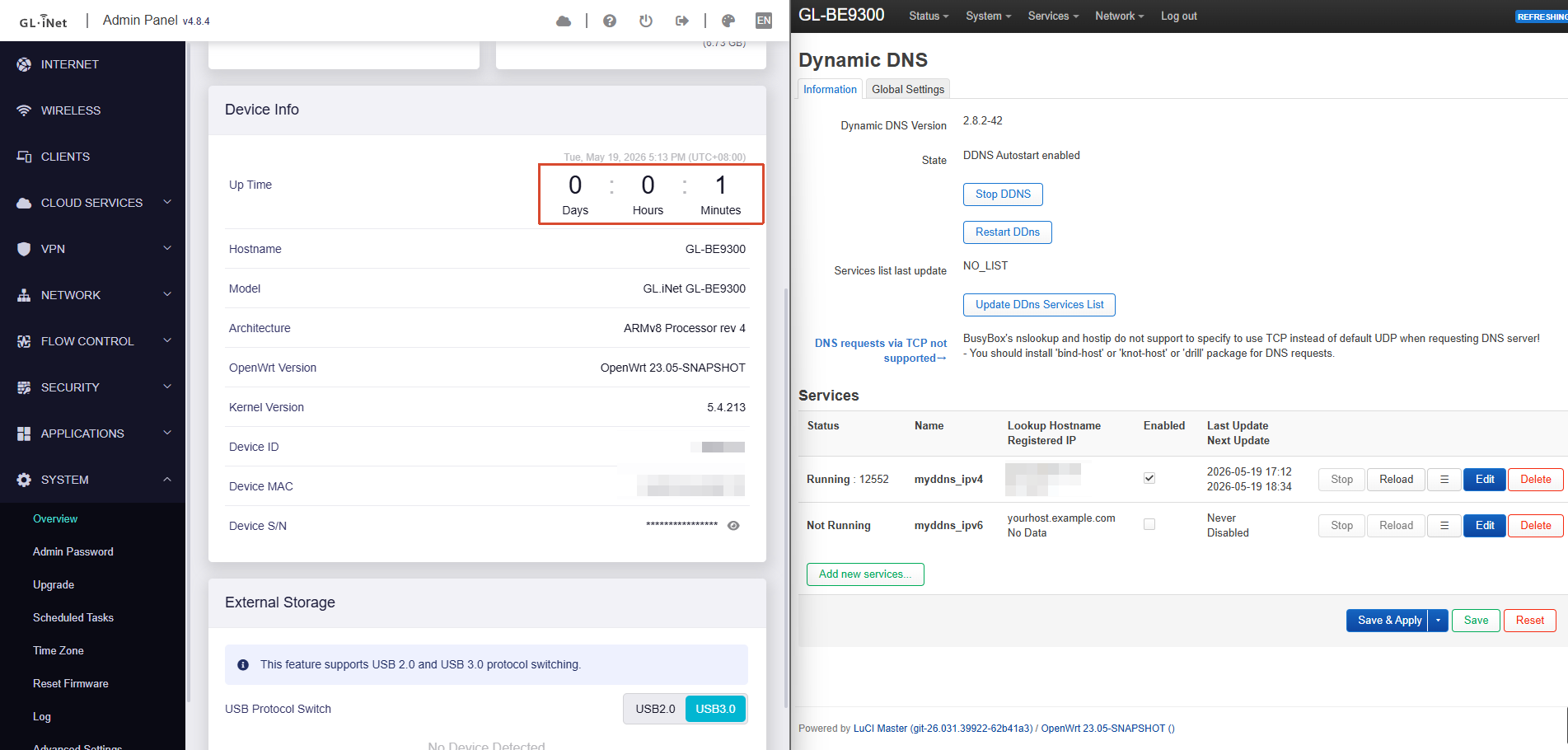

We tested locally using the BE9300 v4.8.4 together with luci-app-ddns, and everything appears to work normally.
After configuring DDNS with NO-IP, the device was still functioning properly after a reboot.
So the issue may not actually be related to DDNS, but instead caused by some other unknown factor.
