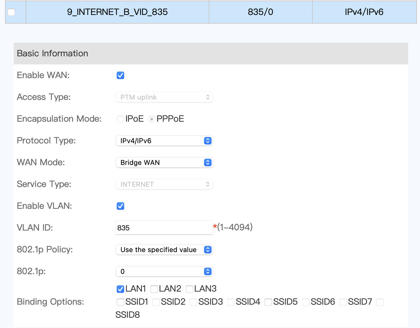

Settings of Huawei DN8245V-70 in bridge mode:

I would try to remove the VLAN ID (=1) from the modem and set it on the GL only.
Should you use vlan id 835 on the X3000's setting as well?
Setting VLAN ID to 835 on the GL gives me following message regardless of the settings on the Huawei (VLAN set to 835 or disabled)

Try to remove all DSL options from your Huawei. Since the GL is doing PPPoE the Huawei don't need to do anything.
No Login, no VLAN, no password. Just modem only mode.
