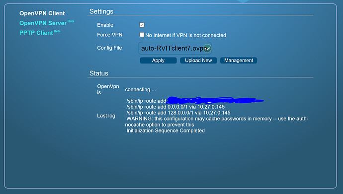

OK. I think I’ve isolated the issue. Every so often, it looks like the VPN client is attempting to reconnect. While it looks as though it fails, I think the router thinks it is connected. Here is what the status page in the GL.iNet UI looks like:
And here is the logfile showing the reconnect with connectivity down:

> Sun Sep 2 13:31:44 2018 daemon.err openvpn[1493]: Halt command was pushed by server (‘disconnected due to new connection by same user’)
> Sun Sep 2 13:31:44 2018 daemon.notice openvpn[1493]: SIGTERM received, sending exit notification to peer

Sun Sep 2 13:31:50 2018 daemon.notice openvpn[2905]: /sbin/ip route add [Server IP Removed]via [ISP IP Removed]
Sun Sep 2 13:31:50 2018 daemon.notice openvpn[2905]: /sbin/ip route add 0.0.0.0/1 via 10.27.0.145
Sun Sep 2 13:31:50 2018 daemon.notice openvpn[2905]: /sbin/ip route add 128.0.0.0/1 via 10.27.0.145
Sun Sep 2 13:31:50 2018 daemon.warn openvpn[2905]: WARNING: this configuration may cache passwords in memory – use the auth-nocache option to prevent this
Sun Sep 2 13:31:50 2018 daemon.notice openvpn[2905]: Initialization Sequence Completed

Seems in your ovpn there are a lot of unsupported options.
I also doubt that the router created multiple connections so the server kick you out.
SSH to the router and check by using ifconfig if there are multiple tun command.
If you have the routers switch configured to enable/disable VPN - configure it to be disabled (default) and reboot the router.
Wow, I think this may have worked. Though I’m not sure why.
At startup, I could clearly see two OpenVPN processes sort of ‘leap frogging’ eachother. With the switch off, there is only one.
And the connection also appears much more stable after startup. Clients appear to keep and hold a VPN connection and it looks like all the DHCPINFORM DHCPACK traffic has subsided.
What about the switch could have led to all of that instability? The physical switch is one of the reasons we went with these units, as the ability for edge users to disable the VPN for certain applications is important. Is there a way to reintroduce the switch functionality without compromising VPN stability?
Thanks for your help!
There is a race condition in the initscripts. /etc/init.d/initswitch first starts openvpn, then in /etc/init.d/startvpn starts openvpn agian. They conflict with each other. Disabling the switch masks the problem.
For more info see: VPN Instability getting old - #5 by nopro404
In that post I list a few lines you can add to the startvpn script to get the switch to work again.
So far this is working great, thanks for the assistance!
