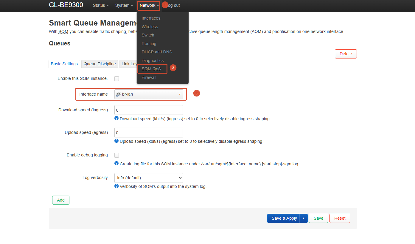

I am also running 4.9 op24 on my flint 2. I have enabled sqm, and it worked as intended in the main ssid.
But when I connect to the separate guest network, the device ignores the SQM rule and goes beyond the limit. Is this intended? On the other hand, the QoS limit worked within both the main and guest ssid
Yes, this is expected behavior.
At the moment, SQM is applied only to br-lan (the Main LAN network).
If you would like SQM to apply to the Guest network as well, you can manually install luci-app-sqm and configure it in LuCI to use the active WAN interface instead:
  1. SSH into the router and install luci-app-sqm:
opkg update && opkg install luci-app-sqm
  1. Go to LuCI → Network → SQM QoS and change the interface:
We will consider improving this behavior in a future firmware release.
